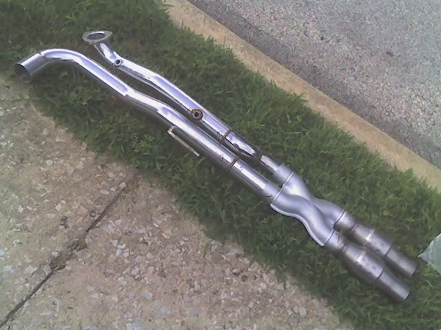

My 2.5 true duals, all mandrel bent, all stainless:
Mopar headers
Modified mopar downpipes
Magnaflow x pipe
thunderbolt motorsports "spun mettalic" bullet cats. (you can see daylight through these, each rated for 6.0L)
Magnaflow 14x9s
3" Spintech over frame pipes and polished tips.
Never heard a truck I liked the sound of more than mine. I didn't want a spintech kit because I think they sound like ass. This took two days to fab and tack weld together, then I had a shop seal it. Total cost was around 900 dollars exhaust port to tips. The hardest part was getting that s-bend right to clear the transmission cross member. The system is flanged behind the cats so I can run without mufflers at the track if I choose.
