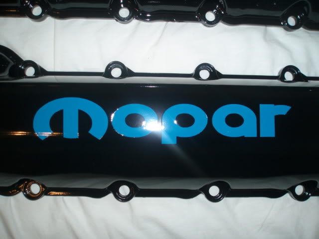

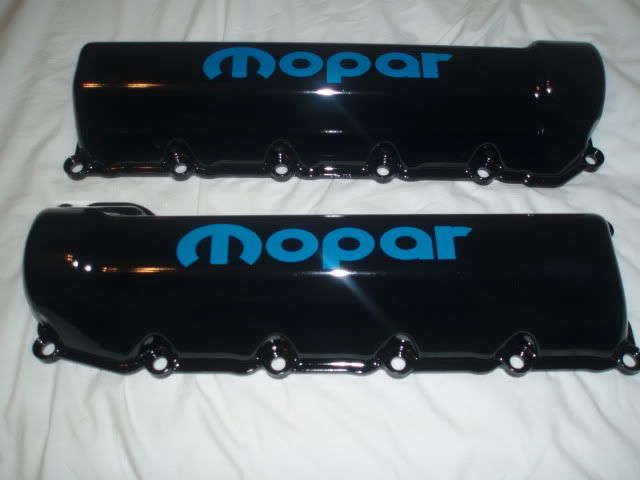

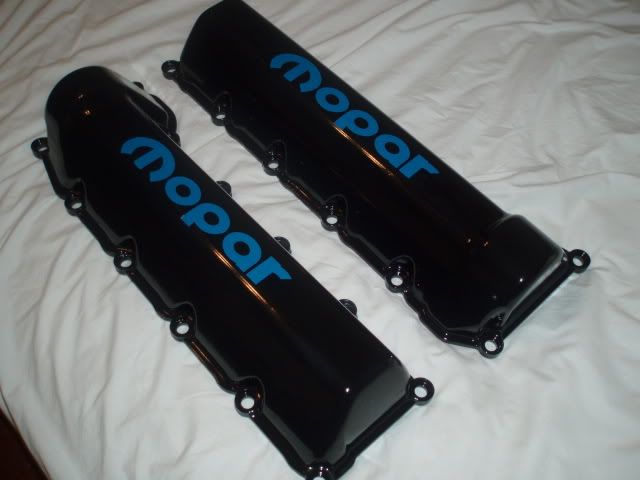

I just got done painting up my 4.7 valve covers.:mullet: I am very happy with the way they turned out. Didn't think I would be able to do them this nice myself but after getting a few quotes on getting them powder coated like this I decided I was gonna paint.
Just thought I would share.:D

When I got the valve covers they were all nasty and oiled up so after soaking them in degreaser for awhile I scrubbed them up clean. Then the surface was all cast and unfinished so I hit them with some 120 grit sandpaper and really went to town on them to get them smooth. Once they were to my liking I hit them with some finer sandpaper (400) to get some of the deeper grooves out. After that I made sure to clean them up real well with dish soap and water and then hit them with some rubbing alcohol. Once they dried I sprayed them with the primer and blue paint following the directions on the cans. I let the blue paint cure for a week and in the mean time I went out and got two vinyls of the mopar emblem made for $12 bucks. After a week passed and the paint was fully cured I wetsanded them lightly with some 400 grit paper and then laid down the vinyls where I wanted them. Then I painted them black and peeled the vinyls off before the paint completely setup so the lines wouldn't be to hard. Then I clear coated with the paint. After all was said and done it ended up costing me around $30 bucks to paint them, most of the cost being because the damn paint is like $5 bucks a can.
