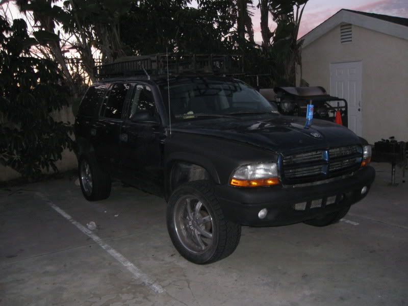

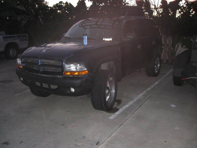

ok so i posted a bit back about the wreck, well here's some update pics. all i have left to do is replace the hood and the grill, the bumper and fenders have been replaced (and sprayed flat black to help blend a little better than the silver and grey they were) the rad support was salvagable. it was in fact not bent. it was actually pushed back so far it caused the body pucks to slide back and the fender held it back at an angle. once i pulled the fenders off and loosened the mounts i yanked the rad support forward and retightened the bolts, then it all mounted up. anyways here are two pics taken today right after i painted the fenders.
