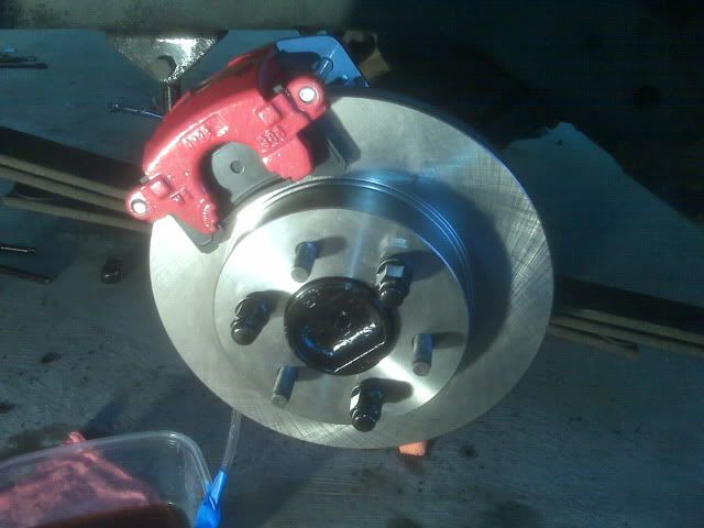

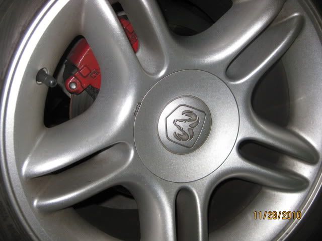

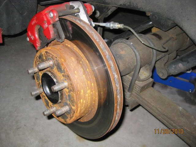

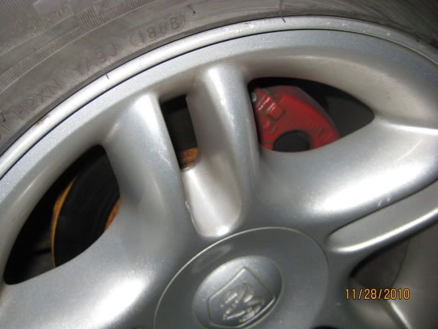

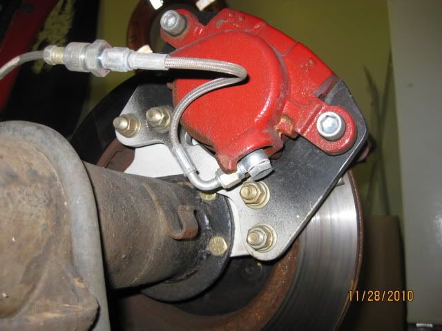

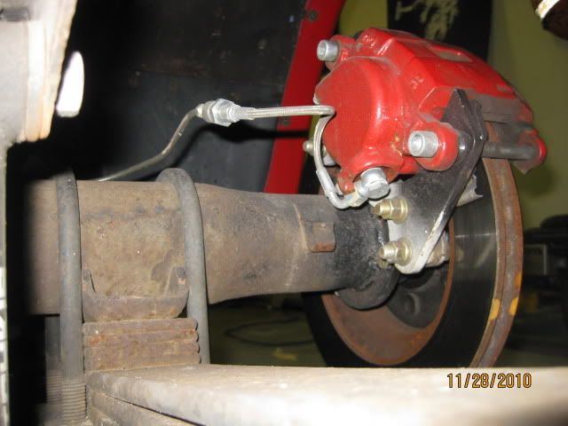

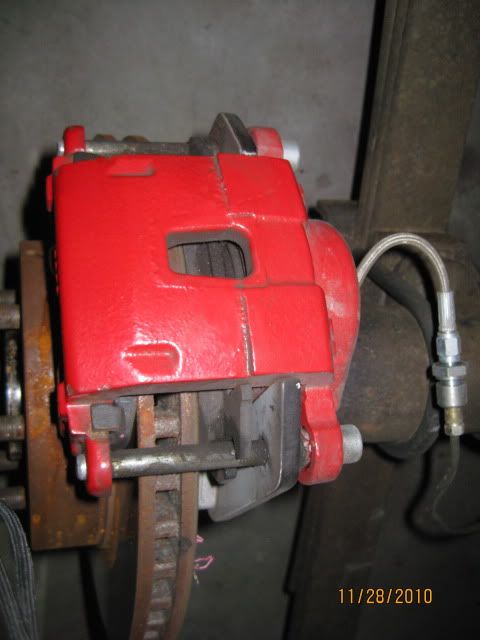

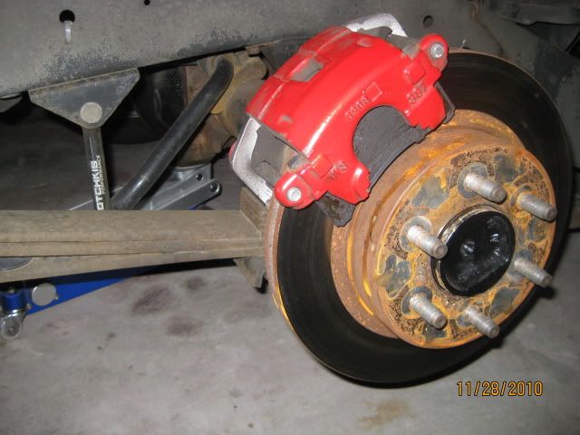

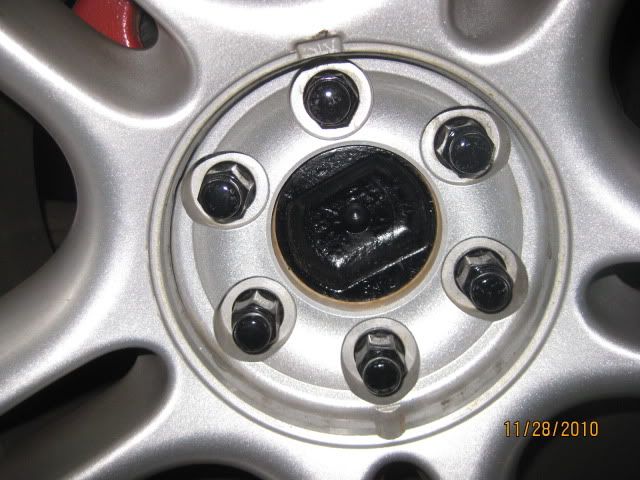

These pictures were taken for jrp1588 but figured id post them up for everybody in case somebody is interested in this kit. The first picture is the new rotors from TSM and the calipers after i painted them. the second is right after install. The last ones i shot today, so ignore the dirt and surface rust. I do not have any pics of the brackets by themselves. They have black paint on them because i had to shorten the threaded bosses for the caliper slide pins, this was manufacturer error and i did not feel like waiting by shipping them back. Besides the brackets being white, i was extremely happy with this kit and highly recommend it.

i had to grind down the threaded bosses on the caliper bracket. TSM sent me brackets with 1/2" bosses when they are supposed to be 1/4". i called them up when shit didnt fit and they were very nice about it and offered to help, but i didnt feel like waiting for shipping so i marked a line around them halfway and grinded them to that line, chased the threads and shot some paint on them. only issue i had, but i didnt even mind, gave me something to do lol

Will 15" rims fit over these? nice work man...
581 Posts
Discussion Starter · #20 ·
I am not sure if 15"s will clear. if you call TSM they might know, the older gentlemen who works there designed this kit for his own dakota, so if hes available he should know
