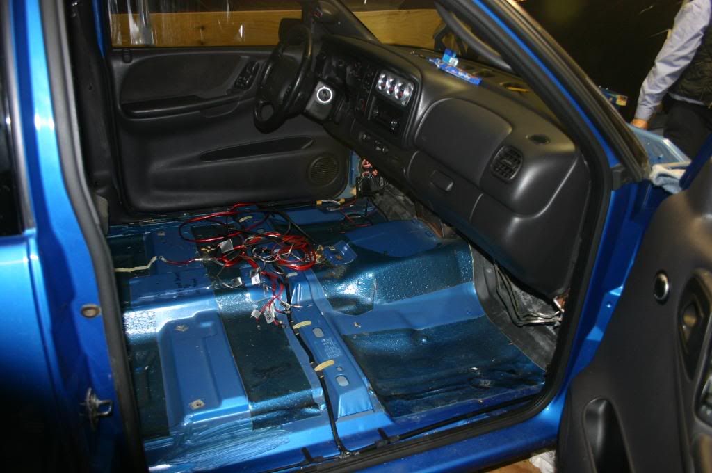

I remember when my engine bay looked like that only a month ago.. Look where i am now, driving it. Keep up the work man, ull get it done! :mullet:
What r u doing to the interior?

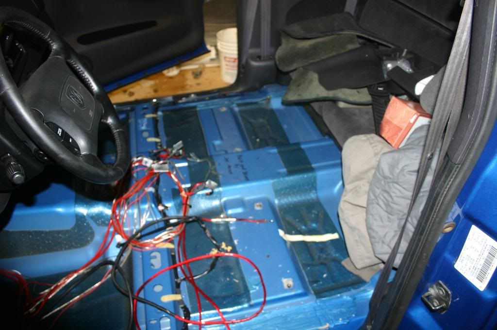

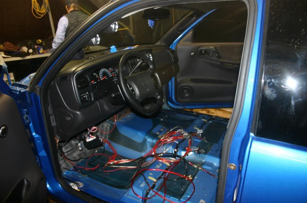

I had to remove the carpet to cut the floor for the 6 speed. Im putting new carpet in.
