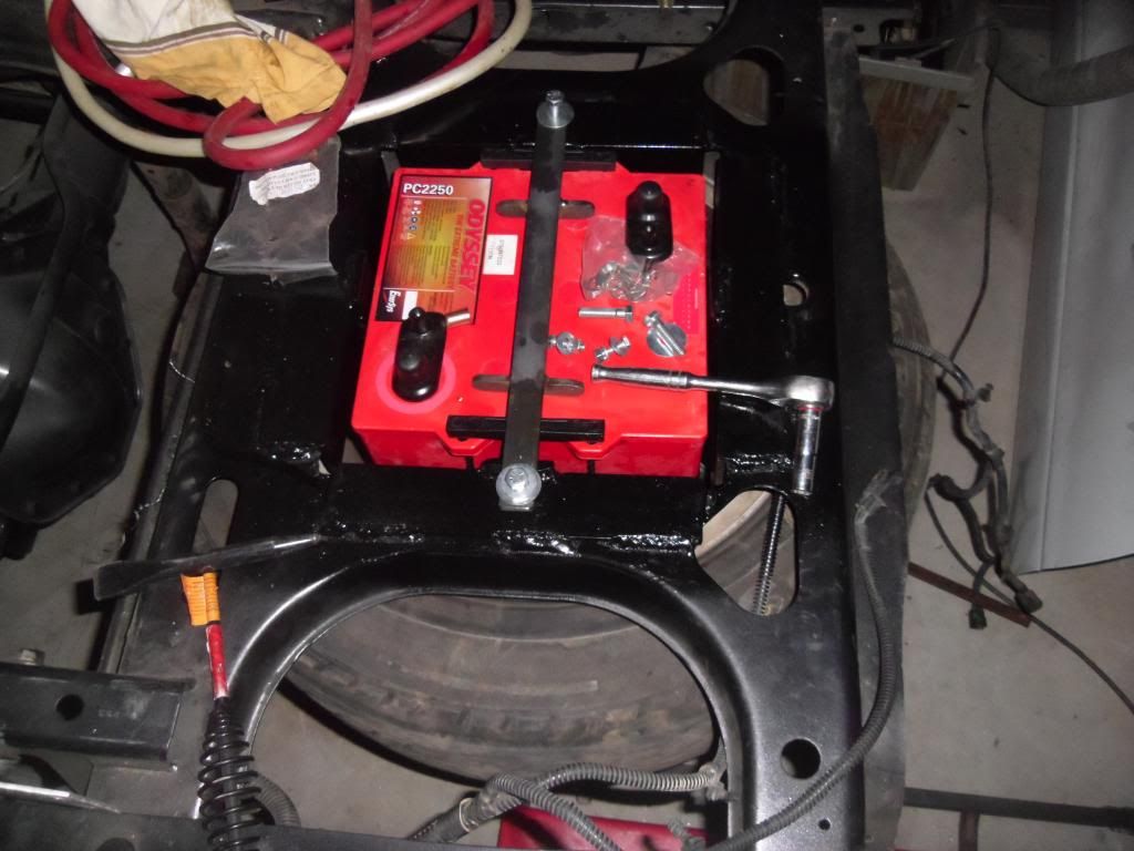

shot of the spare in the truck:

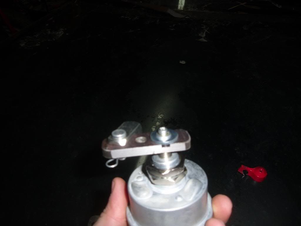

my abortion of a battery switch: (corded drill is not as delicate as my cordless i forgot at work)

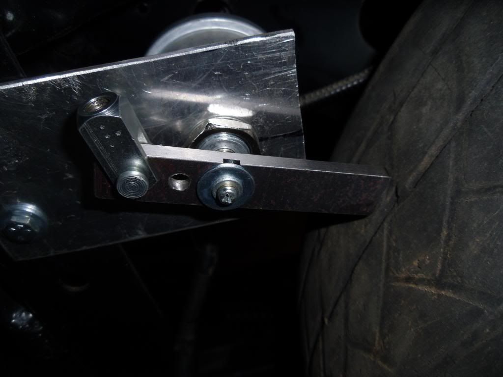

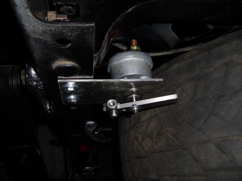

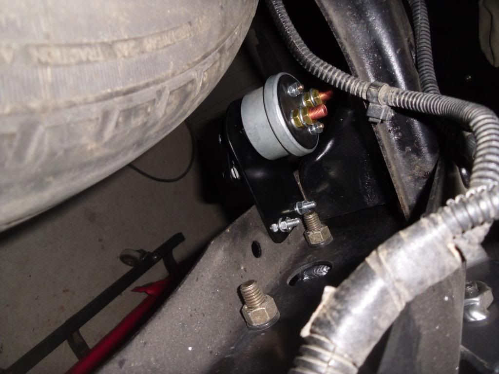

battery switch mounted still have to finish some work on the bracket and switch its self, also add my pull rod:
5

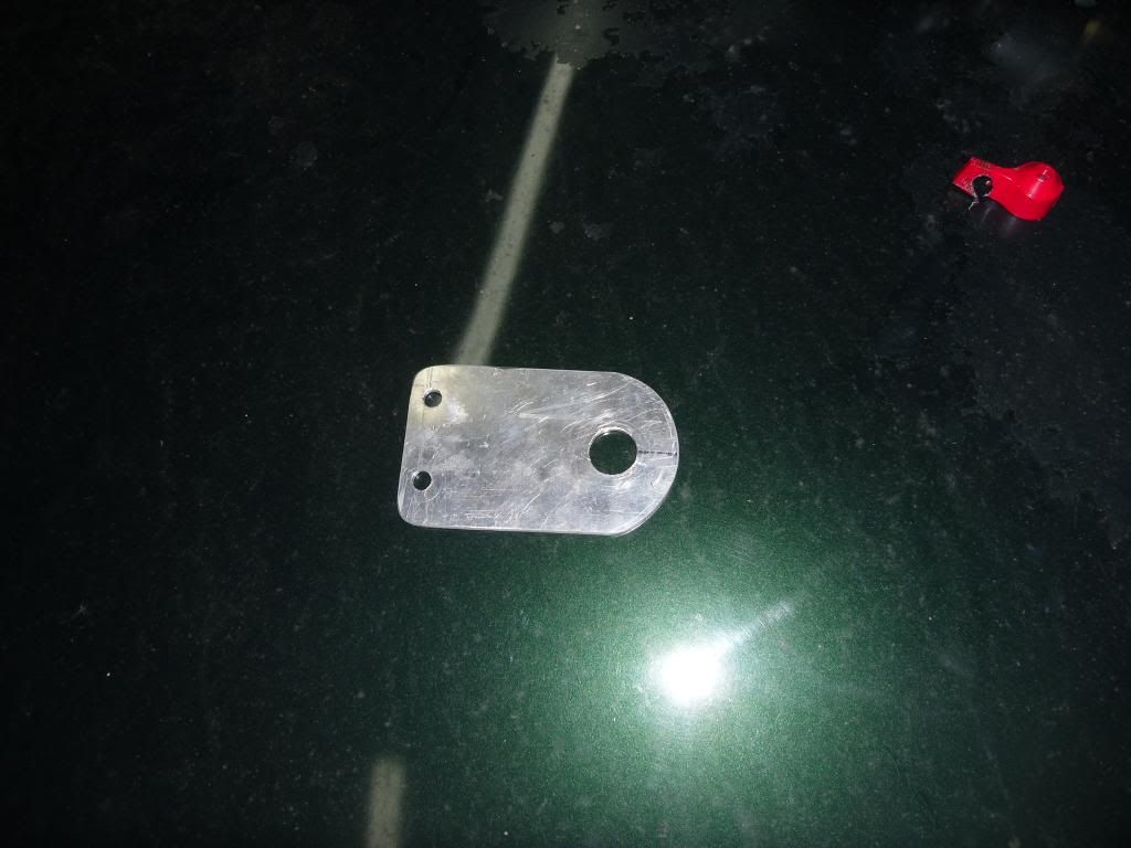

fixed the bracket:
fixed the switch:

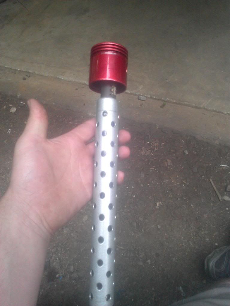

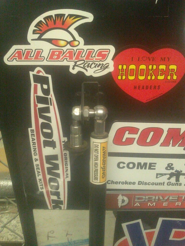

threaded some rods( different lengths) to go out through the bumper to kill the power:

what gauge wire are you going to use for the battery? do you have a facebook? I would like to add you to make it easier to talk.
im going to use 1/0 for the battery and 4 for the alt and starter that is my plan at the moment

installed battery switch:

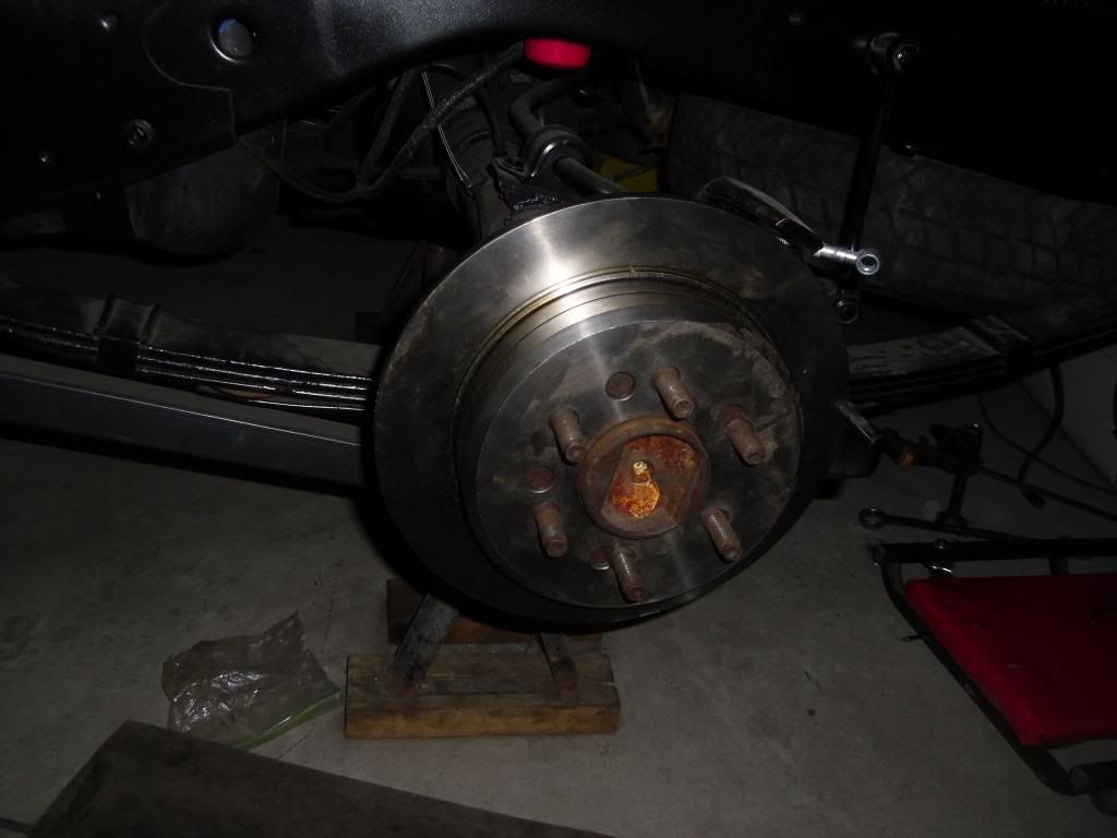

front brakes:

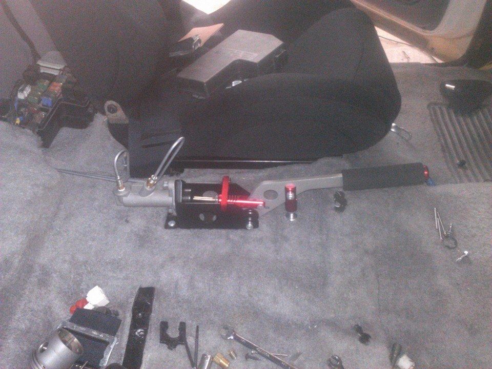

hand brake. check!!!!

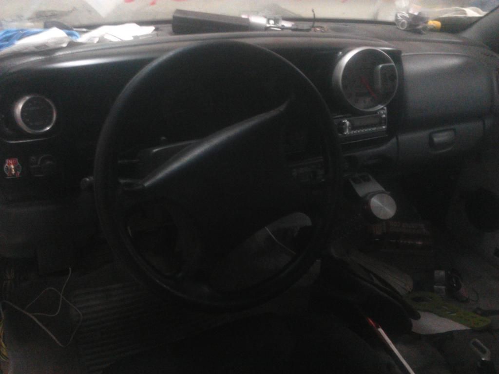

dash:

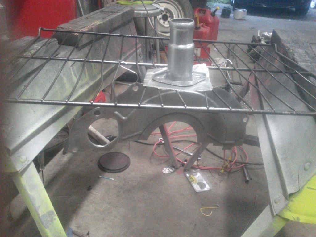

bunch of powder coat!!!!

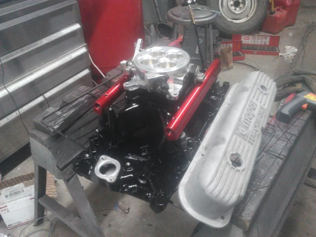

more powder!

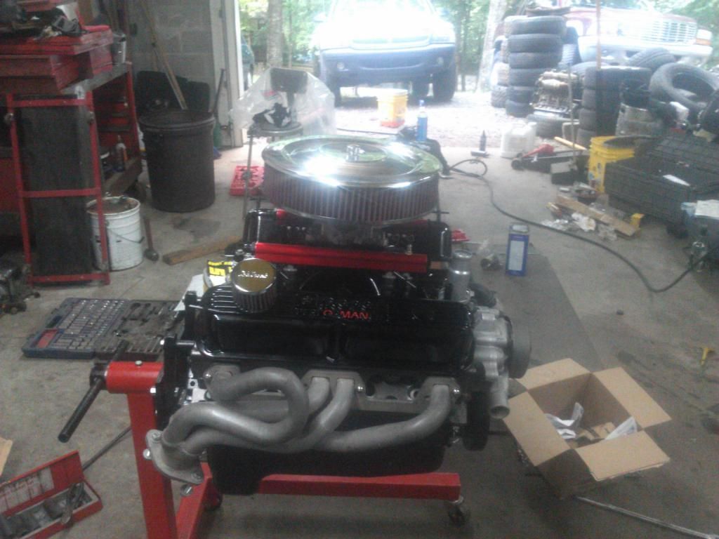

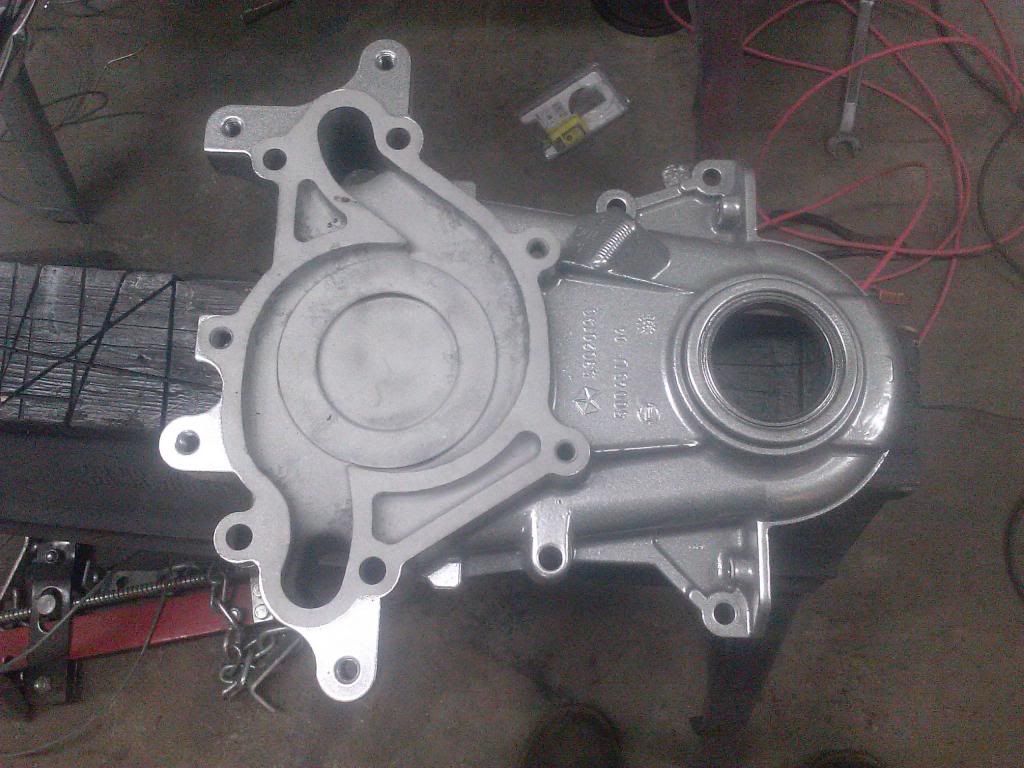

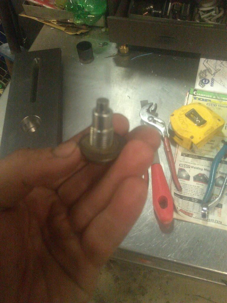

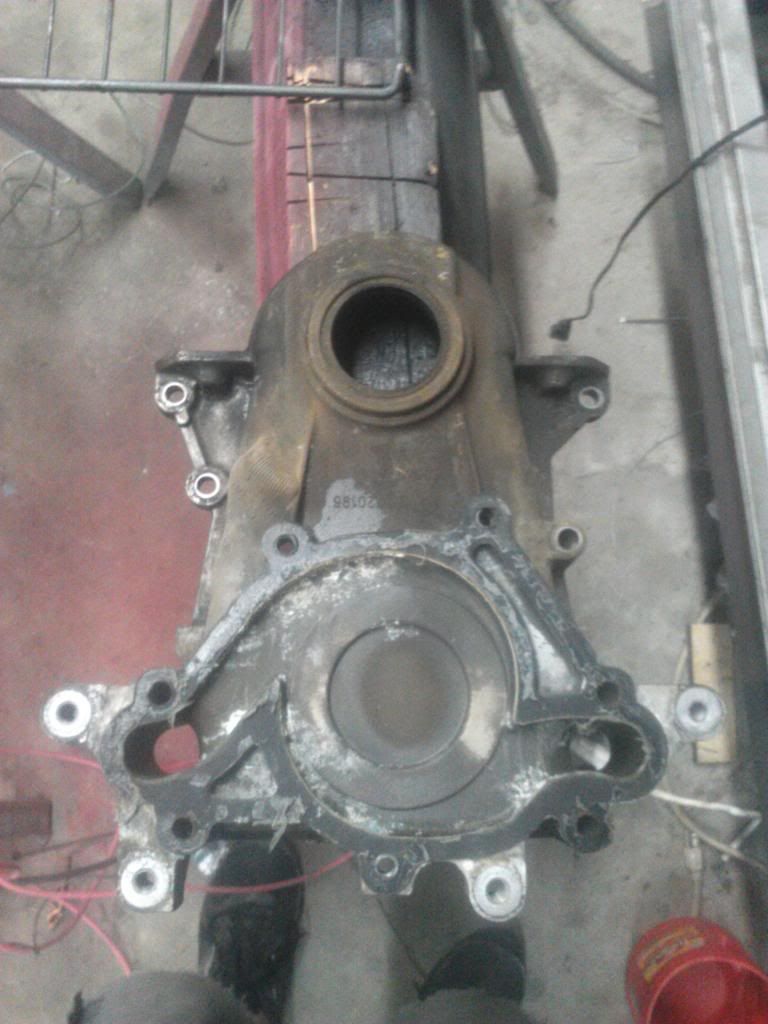

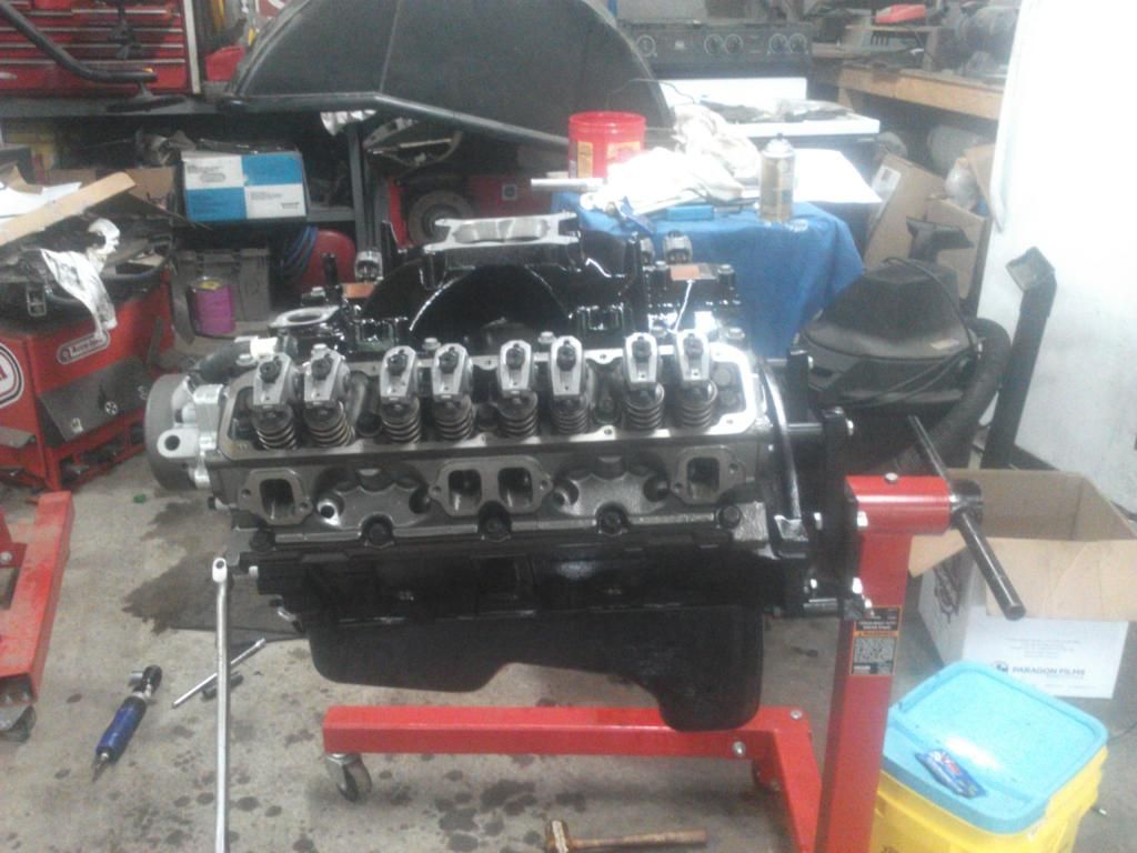

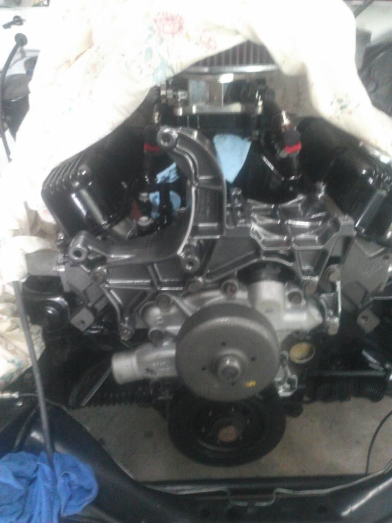

washing motor parts:
made a magnetic drain bolt on the lathe
9

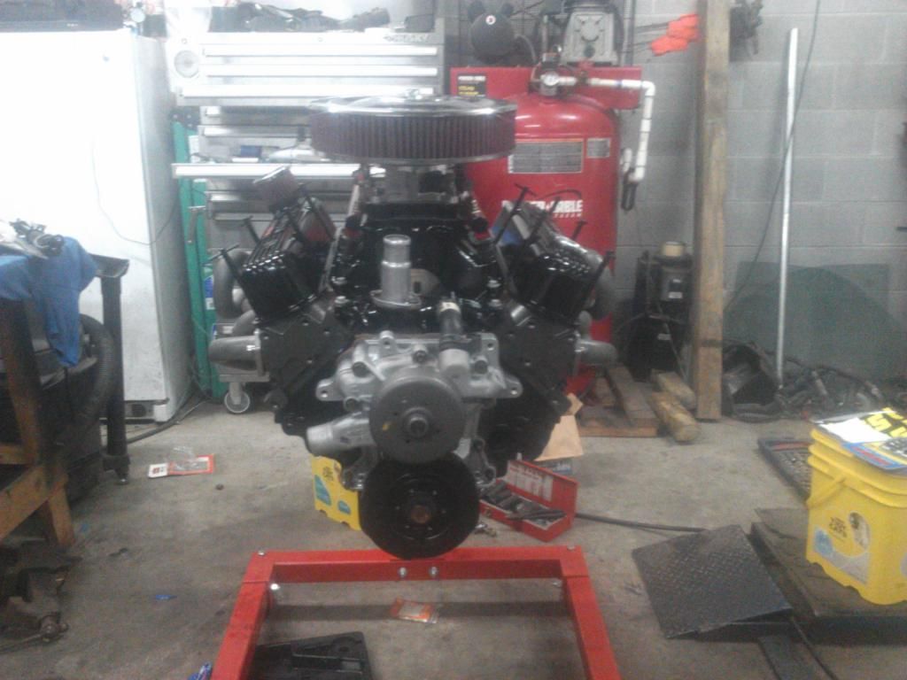

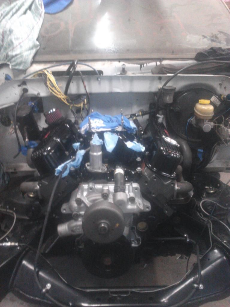

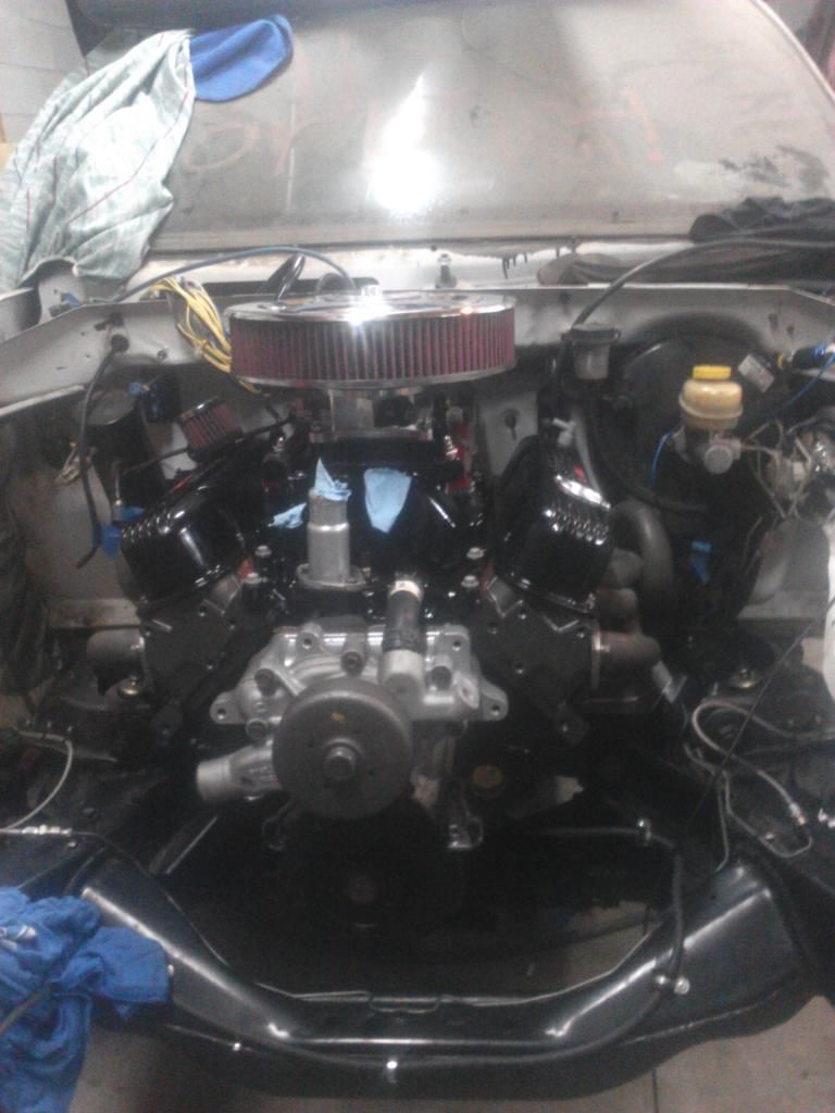

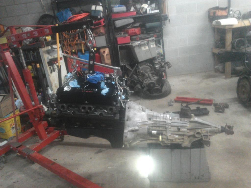

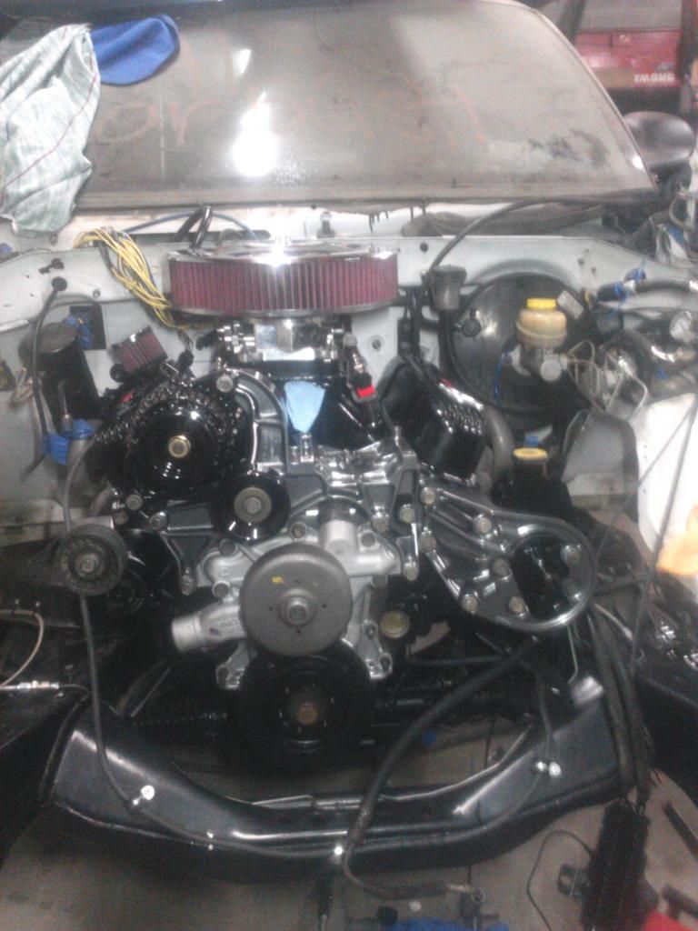

in the truck for the final time!

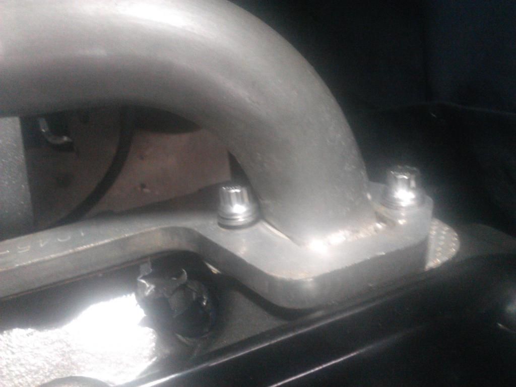

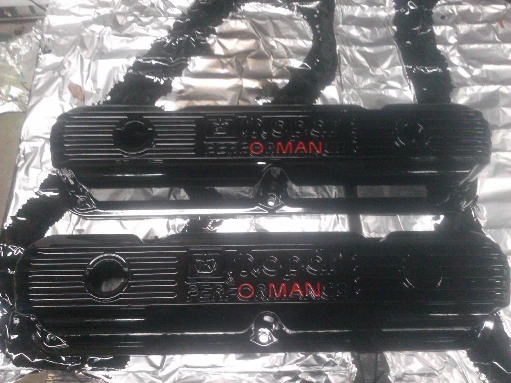

headers were a pain!

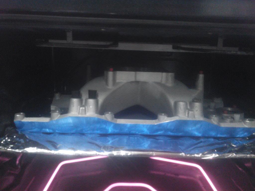

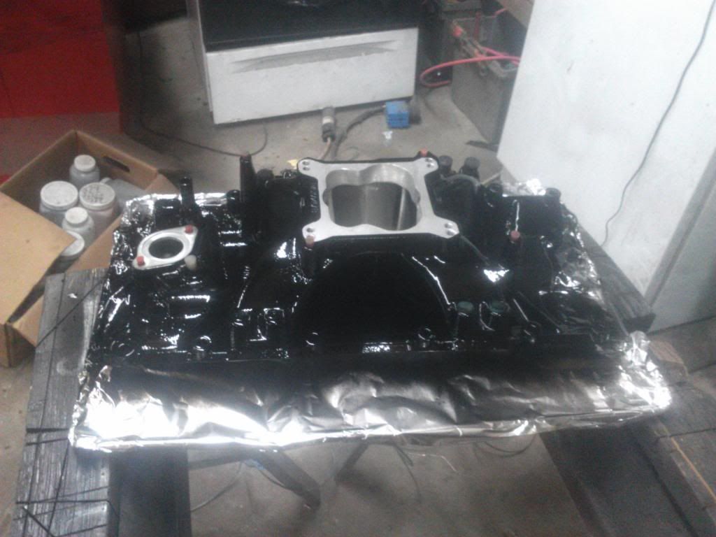

more powdercoat

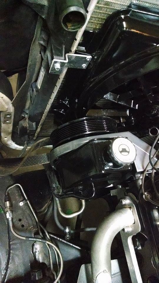

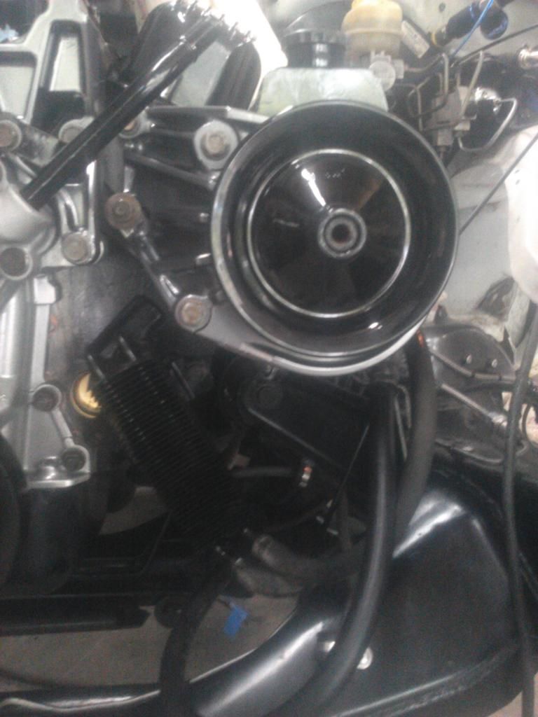

power steering cooler off of the 4x4
12

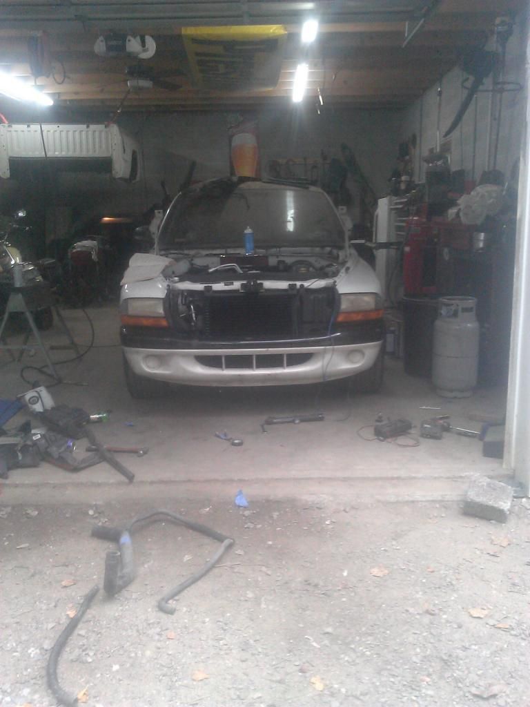

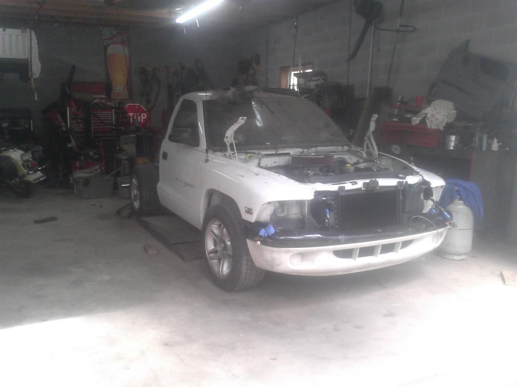

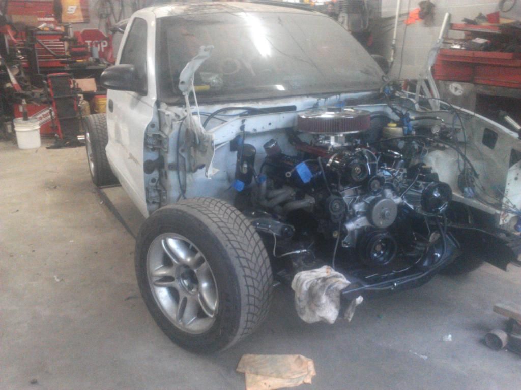

no longer a jackstand queen she rolls!
hahahaha

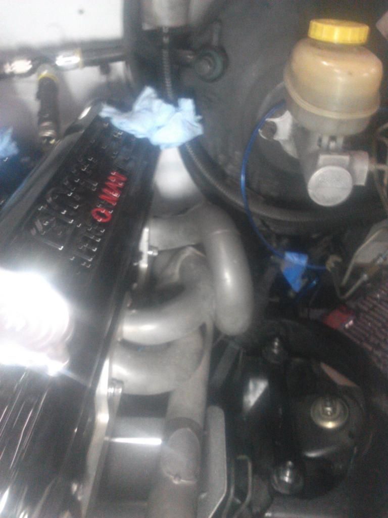

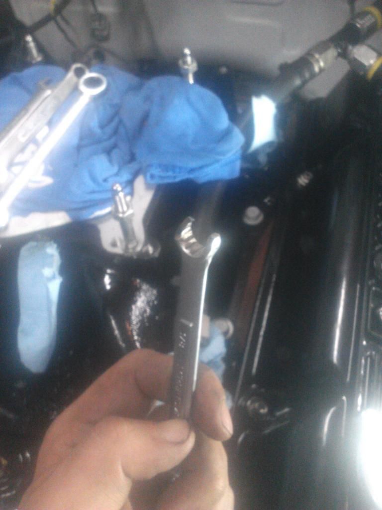

not much room:

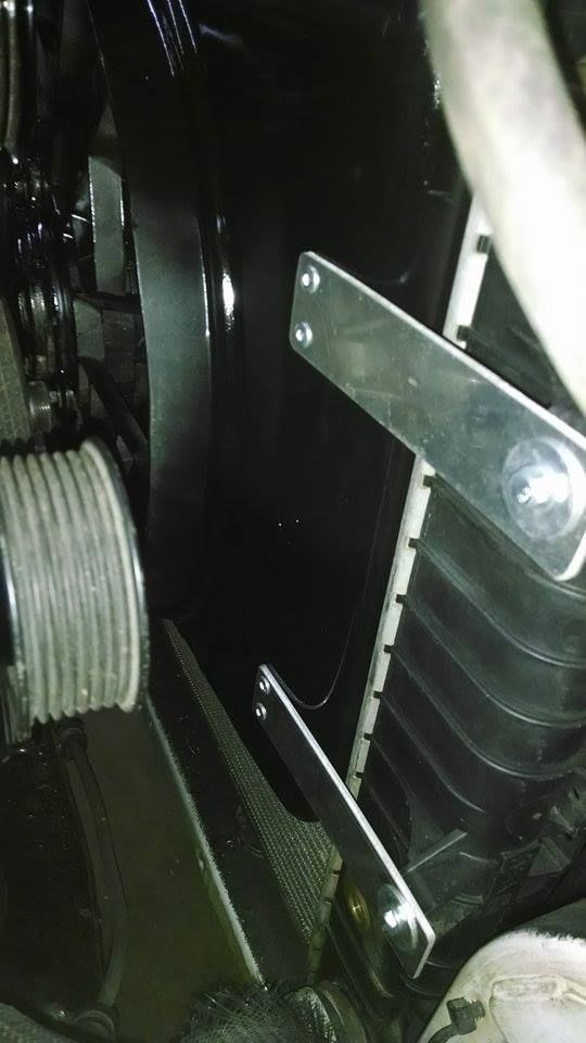

fan no fit!
did some swapping and came up with one that gives me some clearance:
built mounts
misc
ac line don't fit stupid v8 swap
finally. nice man. i need to come visit next time im up there

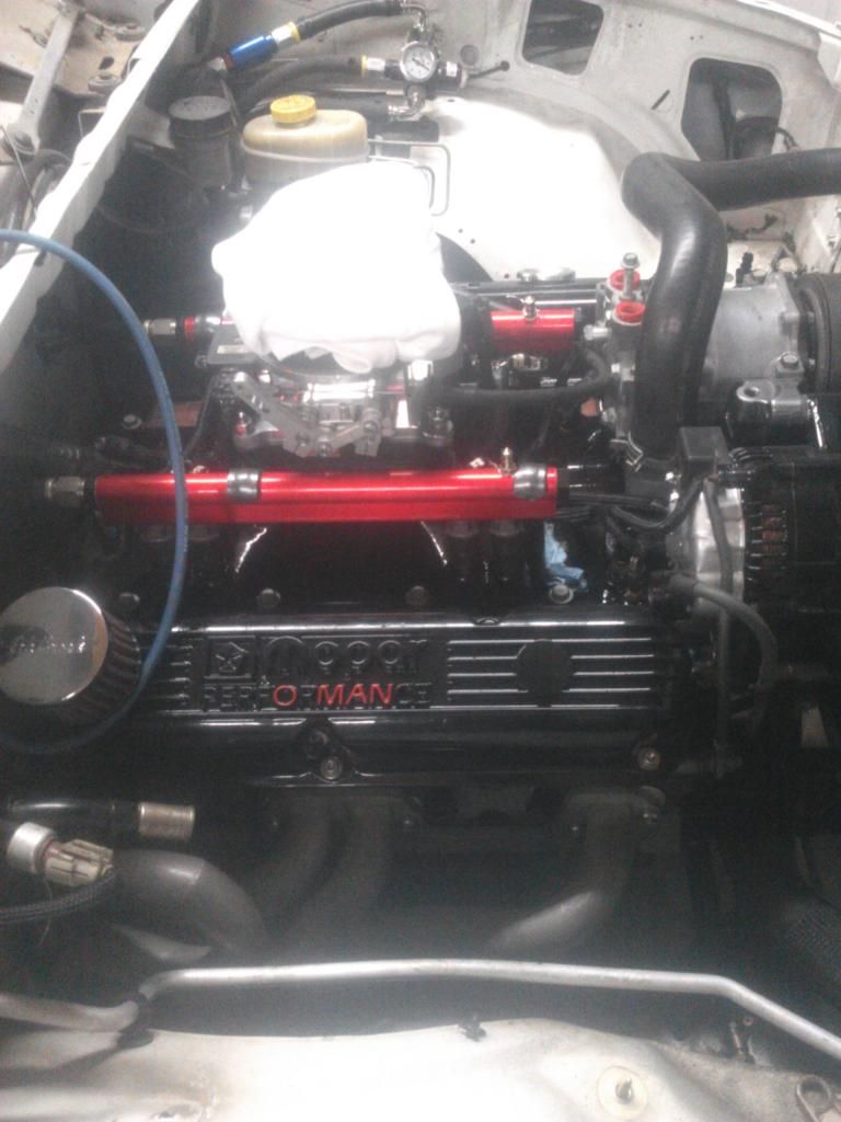

taken long enough haha!!! still have some small ends to button together and finish my megasquirt install then ill get to smell smoke and post videos. im gone racing for the next 3 weekends though so i don't know when ill get time to finish this.
