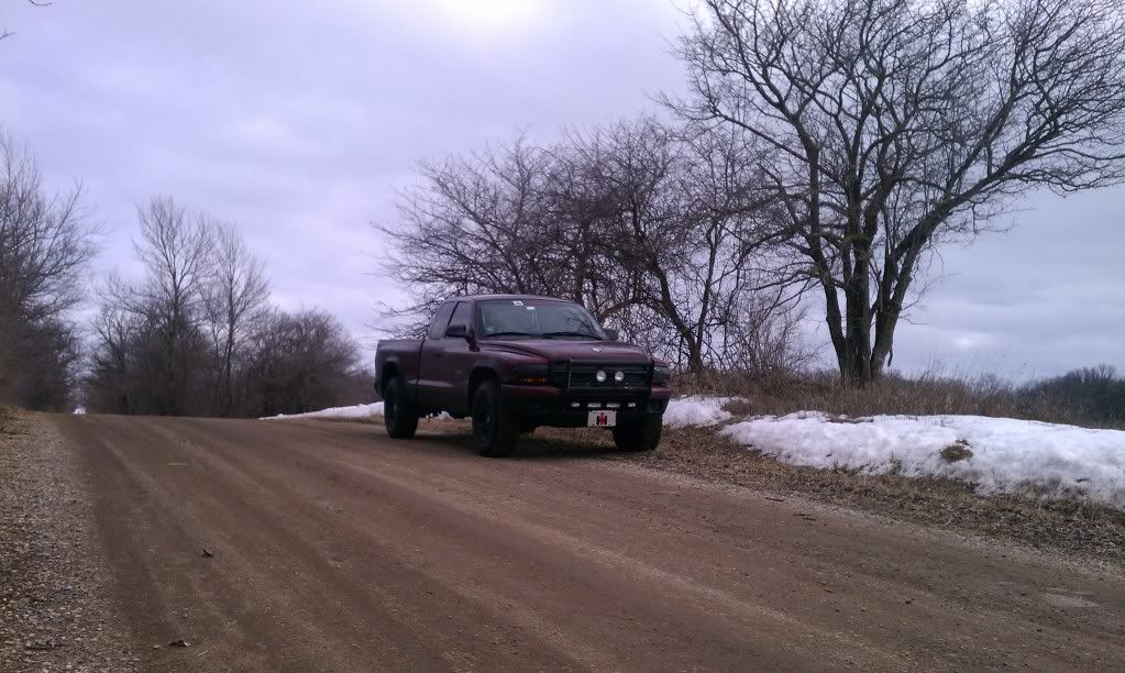

my old custom made westin grill guard, baught a rusty grill guard, sanded it all down, got bar stock from work and started welding, turned out looked really cool, however I doubt it made it any stronger.
I think that should have worked. That's a recent one of the truck
