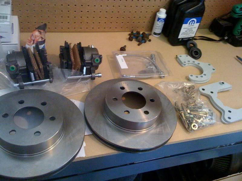

These are pics of the kit and installation of the kit. These are Aves pics over at dakotart. Hope you don't mind me using them!
