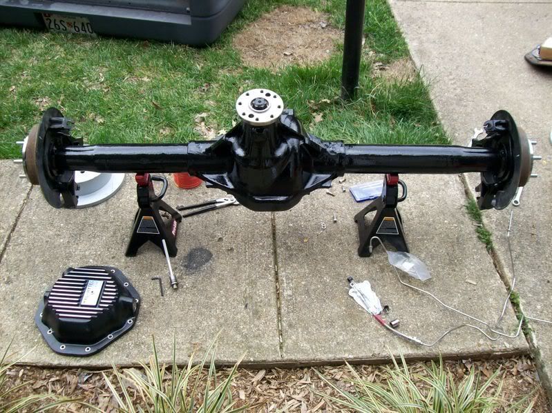

After completing my rear disc installation I decided to post up all of the information I gathered. This post should answer most of the questions asked in regards to converting a drum brake equipped 1997-2004 Dakota/Durango to rear disc. The information has been gathered from my own experience as well as other posters. I used some images from one of 70CUDA383 posts and information from one of Duner posts for Jeep rear disc. Thanks for the info guys!
If anybody has anything to add, post it up and I will edit this thread.
This thread deals with factory rear disc options only and does not deal with any of the aftermarket offerings.
In short, there are no bolt on options for factory rear disc on our drum brake equipped Dakota/Durango's regardless of year of manufacture. All of the options require some kind of modification. Listed below are the options, positives and negatives to each, as well as what is required to make them work.
The absolute best way to swap over to rear disc is to get the complete axle assembly out of an 03-04 Dakota/Durango. If you are swapping from Durango to Dakota or Dakota to Durango the only thing that needs to be changed is the shock mounts. This is a piece of cake when compared to changing the axle flanges.
The primary reason disc brakes will not bolt onto drum brake rear ends without mods is due to the backing plate flange location. The pictures taken by 70CUDA383 show the differences in flange placement.

Well after having all this new knowledge if you still want to proceed with swapping your rear drums for discs follow below and I will show how I did it with 03 Durango rear discs.
Before starting you are going to need a pair of these. I cut these on our CNC machine when it became obvious I would need them. They were made from 3/8 plate steel. Trying to remove the factory flanges for reuse is not something I wanted to attempt.
First thing I did was remove the studs. They can be knocked out with a hammer fairly easily. Don't worry about damaging them, they are too short for the disc brakes and will need to be replaced with the proper length stud.
Don't forget to stuff some rags in your axle to protect the bearings.
Below is the stock flange before any work has been started.
