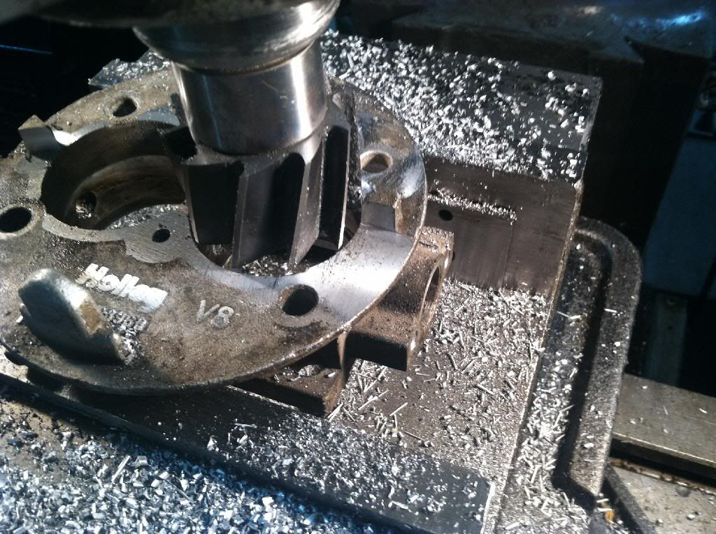

alright guys im still looking for a small cam the one i had lined up fell through.

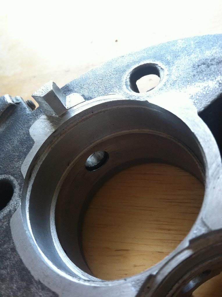

Made some time for machine shop today and chucked up my throttle body in the mill and went to town!
2" shell end mill i plunged down all the way to just before the throttle plate seat. ill do the rest with a flapper wheel. after exam week
still needs a bunch of work but here is the rough cut product

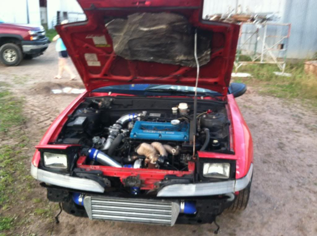

well my first project car is going Bye Bye. finally sold the old goat!!
started when i was 17 never finished it tho 91 awd talon tsi.

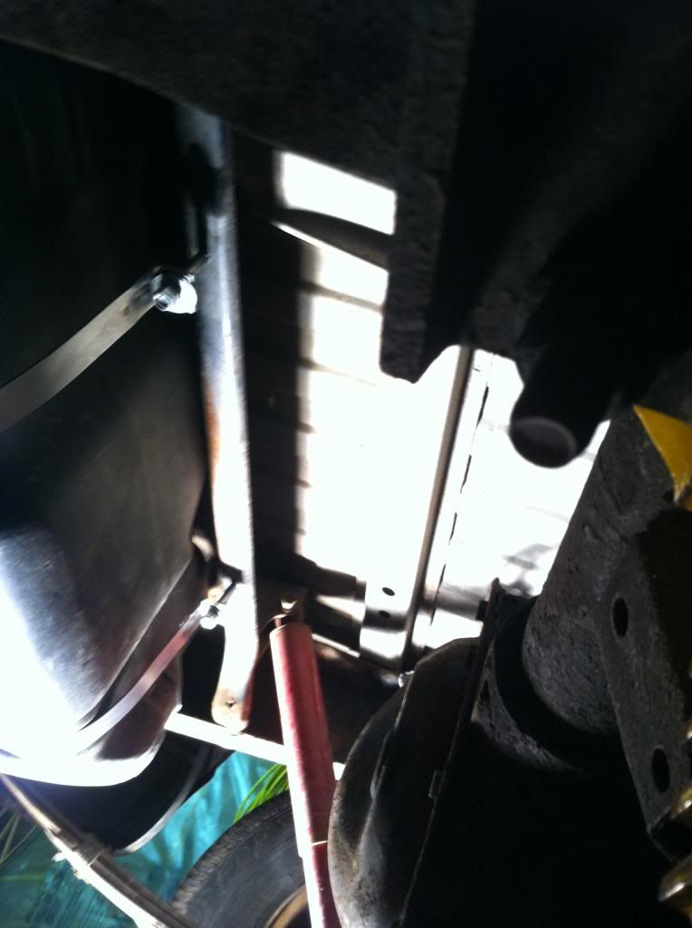

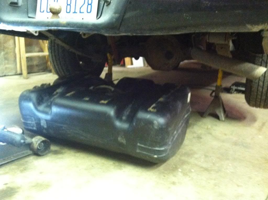

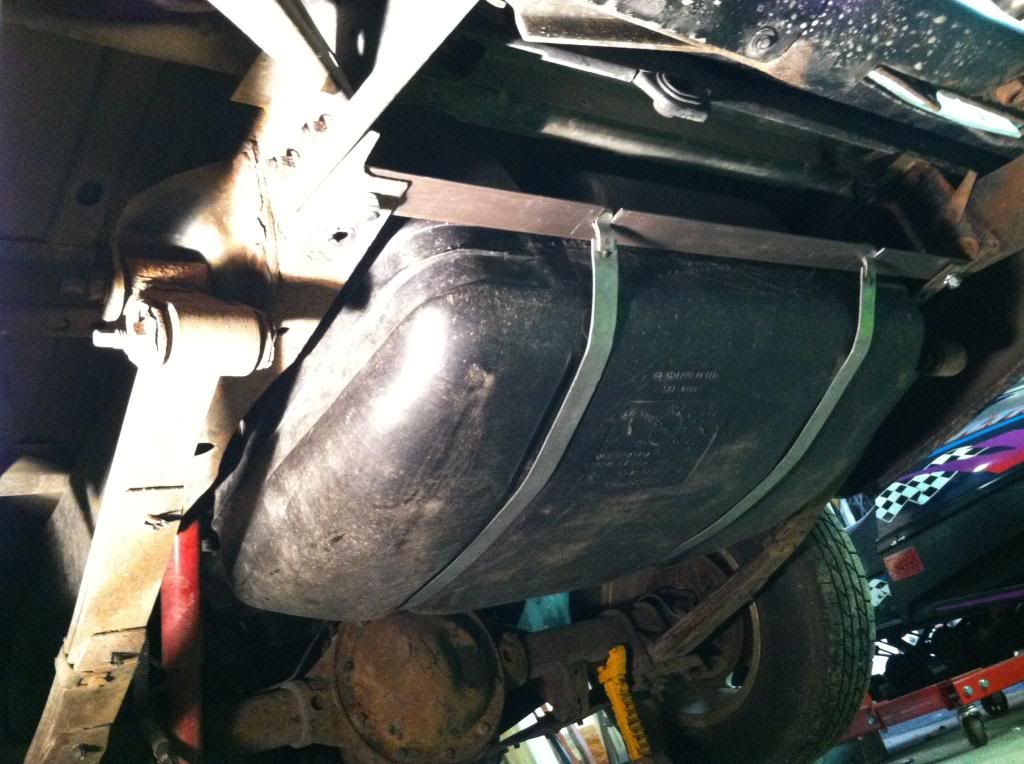

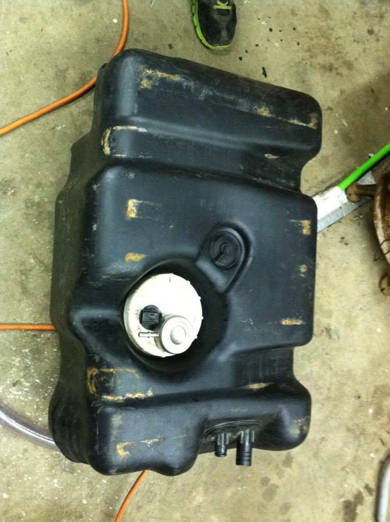

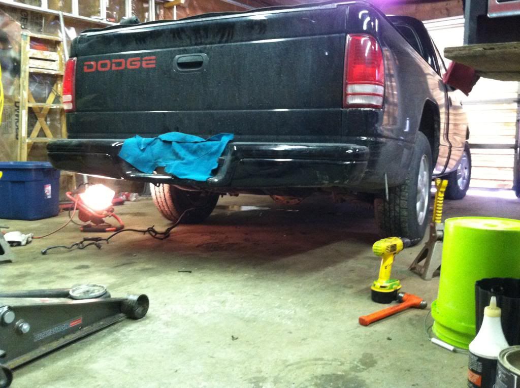

Tank swap to rear!!
Monster tank fit like it was built for a dakota and the swap only cost 100$.
i decided that moving weight around 5 feet back to behind the rear axle would be my single best move at Getting this bastard to hook on the street and shedding a few pounds at the same time. I plan on weighing all the crap i chop out to get a ballpark of weight savings and overall more optimum weight placement.
The Tank is a 23 gallon 96 jeep grand cherokee gas tank and OEM straps
23g of gas 145lbs+tank+straps+pump= roughly 200lbs
Overall weight removed= idk yet
Dropped my spare tire gutted the center of the tire holder with the plasma torch.
made a rear bracket out of 2x2 angle iron. This will do for now till i build the hide away receiver behind the future roll pan. Im sticking with the stock filler neck and just running 3 ft of hose to the rear. Painted all the parts should be driving it tmr
here it is all mocked up. sitting on the ground you cant even tell it is there.
the tank is mounted in this photo

ok so here is the short of it.
The Tank is a 23 gallon 1996 jeep grand cherokee gas tank and OEM straps.
>Rough dimensions or the tank are 30"w X20"L X 12" h.
>Fill/Breather
Located on the drivers side
tank fill barbed fitting is 1.25"
tank fill breather fitting is 1"

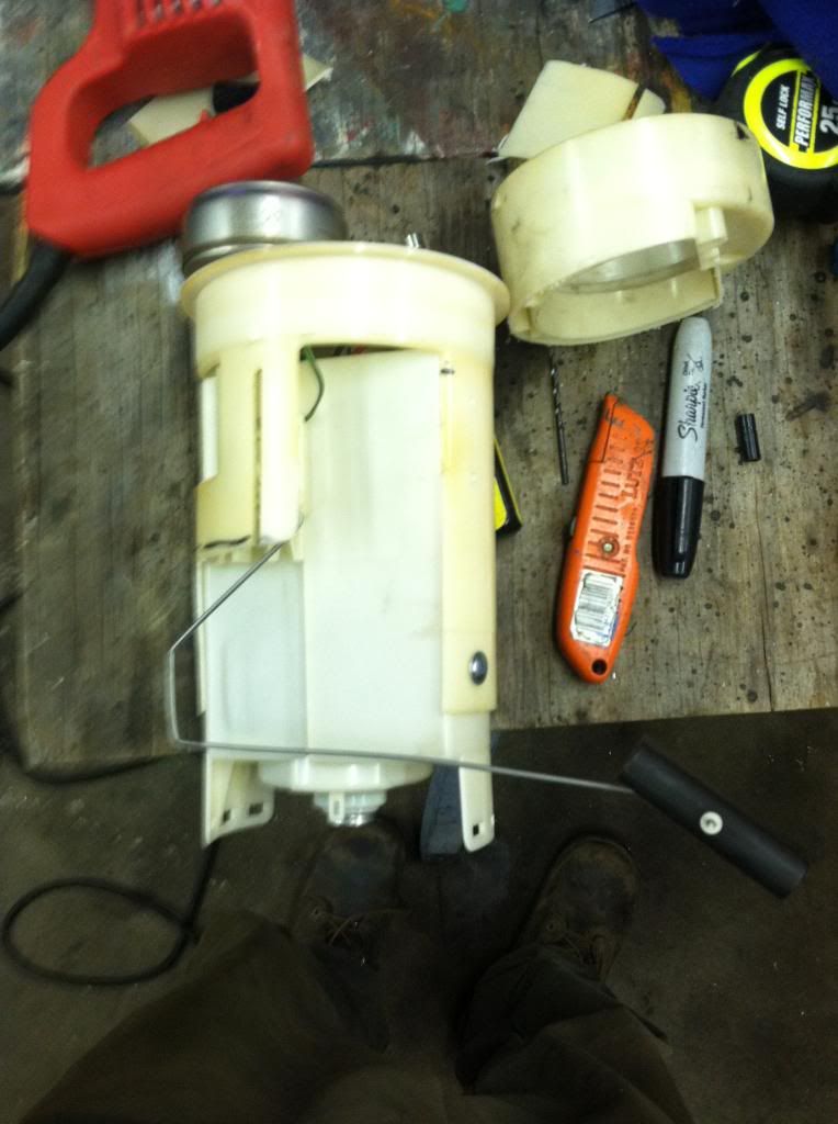

>Pump info
the 96 jeep pump had a 3 wire setup,
i assume they are using ground for both the pump and level sensor on the same wire.
i wanted to use all factory components, but Unfortunately the guy at our pick and pull wanted the pump so i didnt have a chance to even see if it could be wired up.
i was also hoping my pump would drop in and it did... However, the factory 99 dak pump was 2.5" to long. so i shortened the factory dak unit and it fit like a glove.
here is the kicker :funny:
i actually made pvc lines that run from the tank fill location to the stock fill neck. The tank is tucked all the way against the bottom of the bed totally out of sight.. but,Basically both the breather and fuel hose fill with fuel and then vapor lock the tank so i cannot fill the damn thing:huh:
i am just going to yank the lines and relocate the fill neck to inside the box next the driver side tail light. With the tank being so much bigger i only have to fill it once a month anyhow. i am also thinking about lowing the tank a few inches to help shift the center of gravity.
you will also notice that there is no exhaust in the photo. i removed it for the tank install because the factory hanger is in the way. the new exhaust is going to be a bit tight. i plan on running a single mandrel 3" pipe. ill post pics of that later
