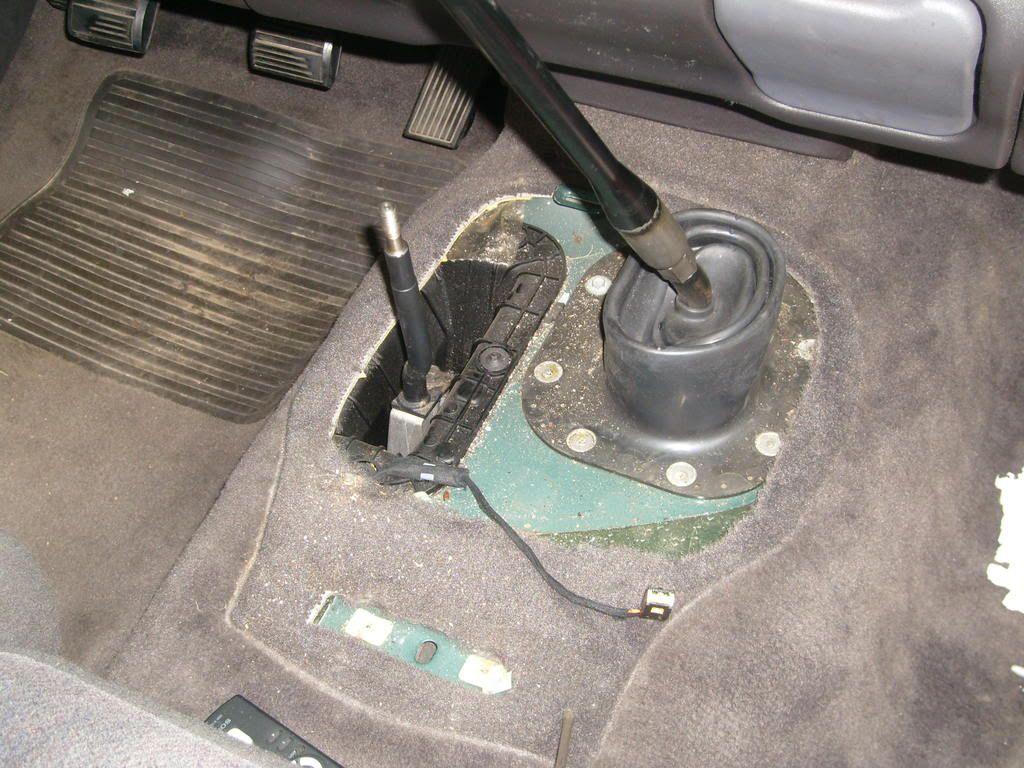

I have had countless threads all stating the same thing so here is my build thread finally! I have most of the automatic sensors and cables unhooked and steering colum converted, auto driveshaft is out and I'm almost ready to put the manual pedal assembly in. Gray truck is the donor and that is now sold. Enjoy! I'll post plenty more pics as the build progress's.

I didn't swap the colums, I just dissassembled the auto shifter lever and removed the items I needed too. I then just put the boot back in place and it looks pretty decent. I also re-attached the clip that makes key assembly think it's park so I can easily use the same key assembly.

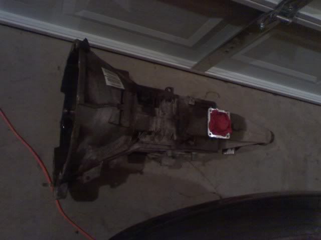

And Yes jmack is correct, the 2 tabs that the nv3500 mounts to the crossmember were broke off, so I had a really good welder friend fix me up.

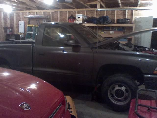

Pics bellow, pedals installed and a shot of the truck sitting on stands, yes thats overspray on the inner fender, only bad paint spot on the truck.
Tonight I removed the crossmember and exhaust, all I have to do next unbolt the tranny cooler lines and unbolt the bellhousing from the engine and the automatic ready to be removed!

automatic is removed! Expect me to put it up for sale soon.

I'm trying, right now I have kitty litter soaking up all of the tranny fluid, once I clean it up I'll snap more pics. I'm planning on taking lots of them during the assembly process.
