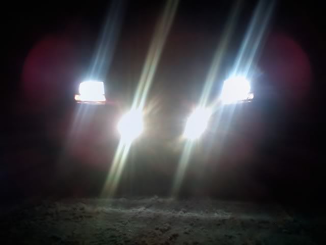

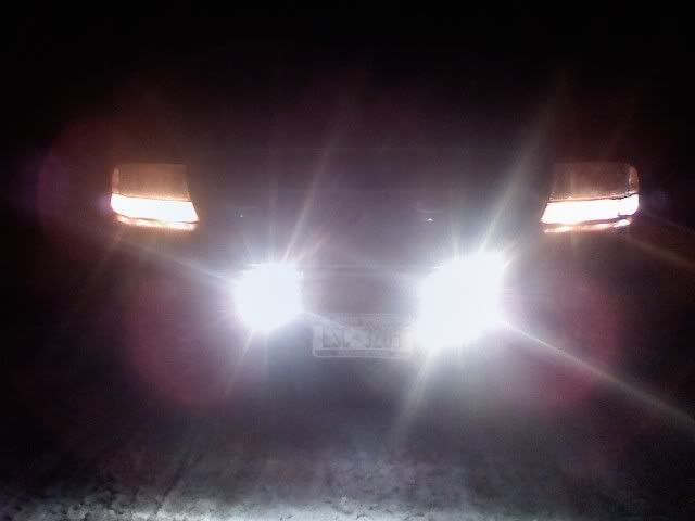

First I had them on the bottom in between the valence holes, they came out cock-eyed, so i top mounted them and they came out perfect
thanks man:mullet:they're called navigator can pick em up at advance, and 14ga
those fogs are great, for everything! ive replaced the factory fogs on every dak ive ever owned with these. and ive used them as reverse lights twice and eliminated the shitty factory reverse lights. they're bright as hell!they're called navigator can pick em up at advance, and 14ga

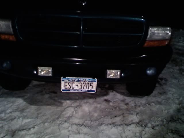

thanks for that man, i would of never know really. But if i replace with say 12ga wire would i get any better light output?and rollers888, i noticed you dont have factory fogs in your pic??? before you run the wires that come with the kit, look and see if your truck has the wires zip tied to the harness next to the radiator. my 04 didnt have factory fogs, but had the wires there. i just put in the fogs, plugged them in, and picked up a factory headlight w/fogs switch on ebay for $15 and put a fuse in the "fog light" spot, and the work just like factory. no adding switches or wires at all.

in my 02 i just modified the existing fog light mounts. but here's how i mounted mine in my 04 that had no factory fogs (not perfect, but its aluminum so it will never rust):i just need a good place to mount them
same manufacturer, i believe. just different shape. i just stick with the round ones because they're the same size as factory fogs.so his square lights and your circle ones are the same?
alright thanks mansame manufacturer, i believe. just different shape. i just stick with the round ones because they're the same size as factory fogs.
