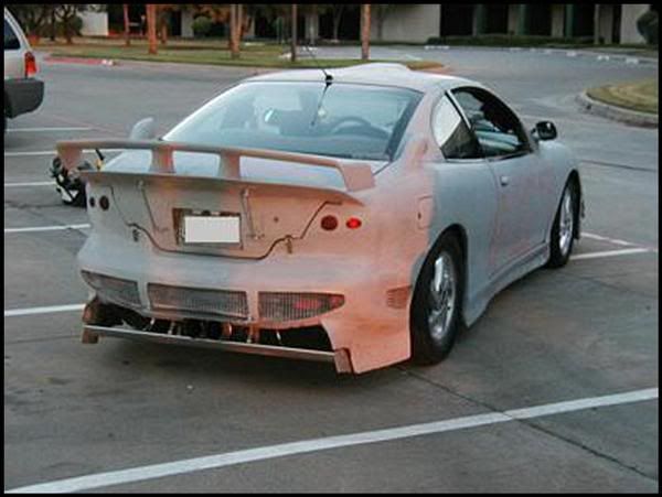

...lol..no i wont do it half ass. i might take alot longer to build it than must...but i do almost all of my work...i built this over 2 yrs time with my son..at the time he was 12..we had a blast ..but it did take awhile...but was worth it..won 17 trophies with that one and wish to hell i hadnt sold it...my son wishes too..he is 15 now...and wanted it...

Do you have some pics of the sunfire painted and finished? Looks like it's still on primer...

So your front fenders are just bondopicasos? I thought I spied stock fender flares in there...
....nope...my little girl was born so i started looking at selling it...then i got hurt on the job and spent a week in the hospital and a year off work...had to sell it...regret it..but had to...the only things that were different was 18" qauntam tek wheels and the door handles got shaved off....but after my divorce...those pics are the only ones that survived. I have tried o contact former car club member for their car show pics..but havent had any luck...
nice I didnt know you had that much experience if body work like that! not my style with the car haha but the durango should look sick!
....yes...very good grasshopper...just for now..they are half glassed and filled.......going to get some FIBERwerx full fiberglass fenders ( for a chevy 1500 - 2007) and glass them into the top half of mine ( like they used to do in the old days......these are just to get me by until i get the widened front prerunner bar that will follow the front bumper better on then i will put the full glass one on..dont like the look of the fiberglass unlimited fenderset right at the headlight..so i am going a different route...but dont worry..2 layers of glass and very little filler..I did it right....they wont crack...these fenders....the rear will be the hard part...

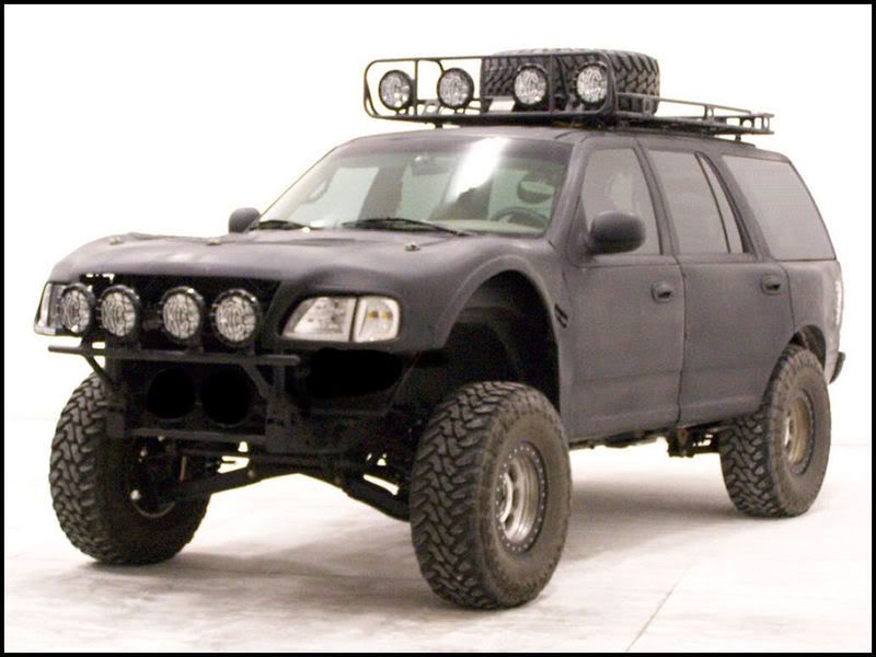

my rear fenders will look something like these...will be a pain bc of the durango rear doors....
so someone has already done up a durango like this? so you ort of have a plan to follow?
not that i can find...can only find ford explorers and expeditions.and a few others.......have done a ton of research about the different trucks...so that my plan..or lack there of...but thats okay...when i did the sunfire i couldnt find stuff that was different or that i like ( the front headlight were from a 2001 civic - people thought I was insane till thay saw it finished...) ..so i made my own plan as i went...and thats what it looks like im going to have to do here...wish i could find " bajadak"...would love to ask him some stuff and see some pics of his dak.......but all over the desert sites and such...he just disappeared.....
