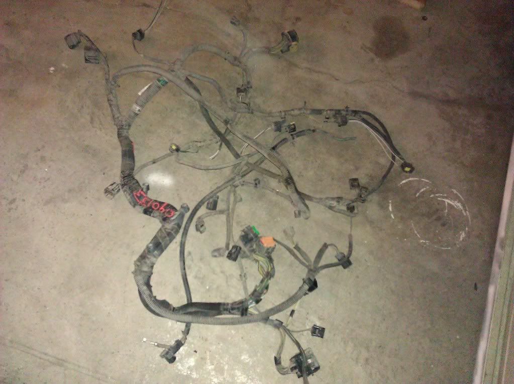

I figured I would throw up a big update. My full build thread is on DF so it gets a little neglected over here. but here's the last pics of building up the motor a bit and some parts I bought.
full complete thread is here, hope it's ok to link it.
http://dodgeforum.com/forum/3rd-gen-dakota/318828-hemi-swap-1yr-plan.html
Here's some pics of my 6.1 hemi valve springs installed and the start of the cam install
All the work done by me, I've never even replaced a water pump before I started this build, just suspension work, fluid changes, and a t-stat or radiator here and there.
the cam getting installed.
