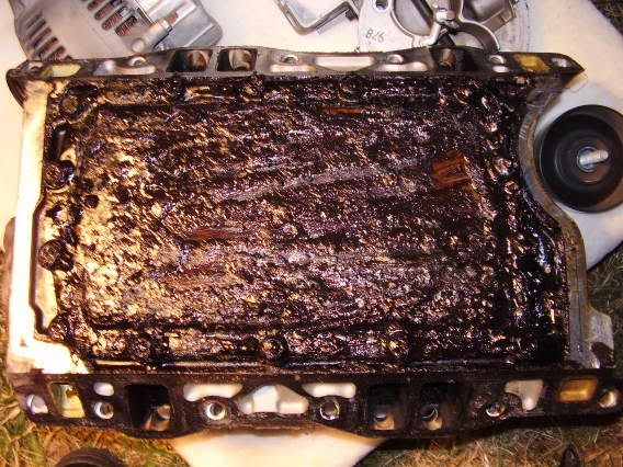

this is sludge
pull your valve covers off and see if something like this is layin on the heads, if so youll be better off pullin the motor out, this is sort of a common issue.

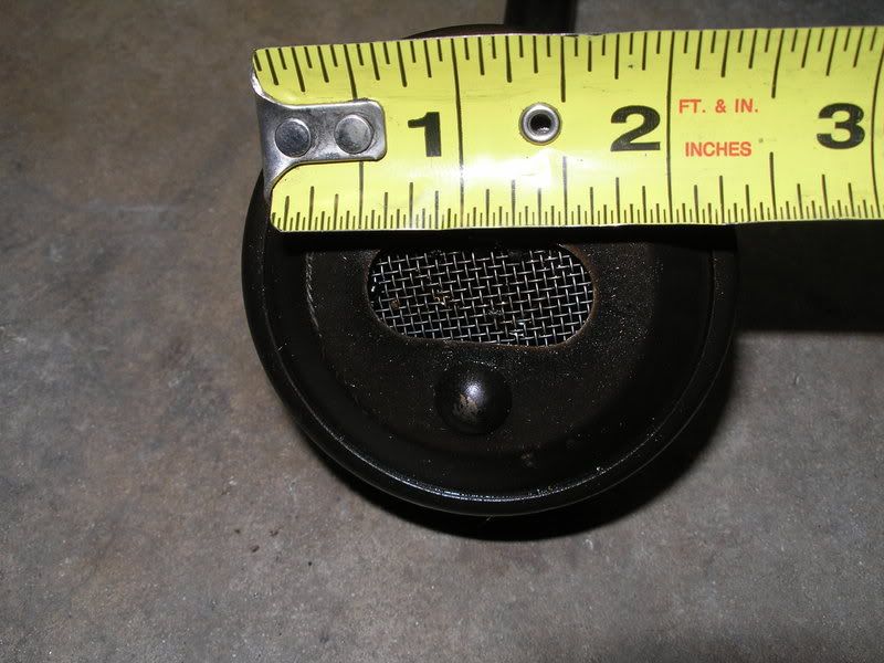

Might want to try flushing the motor with kerosene first since the oil pickup is small and can easily suck up trash that blocks the screen intake
Remove the oil pressure sensor at teh back of the block... and put some compressed air down the port after the flush as well
arent all pickup screen the same? mine in my 360 had the screen the size of the entire bottom instead of bein capped off in the last pic

6 months aint shit to be honest. The sludge pics above is an exceptionally extreme case. You'd be seeing pressure problems before it got that bad.
