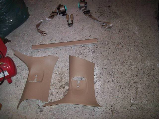

Parts Needed:
  • Seat (4 Bolts)
  • Rear panels with belt access holes (6 screws)
  • Dual belt lock (1 Bolt and 1 washer)
  • Belts (4 Bolts, 4 screws and 2 bolt covers)

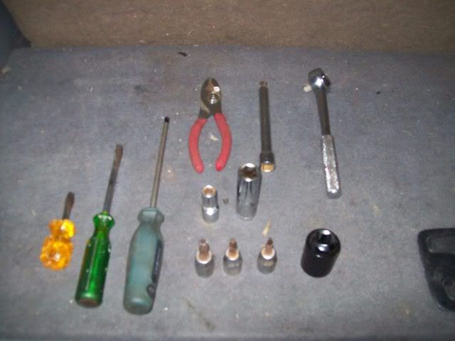

Tools Needed:
  • Sockets
    • 7/8
    • 5/8
    • 10mm
    • extension
  • Torx
    • T-45
    • T-30
    • T-15
  • Pliers
  • Philips screw driver
  • Flat screw driver

Removing Panels and storage compartment
Using a flat screw driver i carefullty popped out the centre panel which was being held on by metal inserts
Once you have that off you will have one screw (phillips) at the top for each corner panel. and the rest just pops off (be carefull). the bottom trim panel near the bumper comes off also using a T-30 torx and a T-15 torx. Side panels have 2 screws each (phillips) that you also take off.
Now the storage
You will take the flat screw driver and pop these 2 caps (one on each side) from the floor and there are 2 bolts (7/8 socket) to take out with an extension
Open the compartment and there is one bolt (10mm) to remove
then in font of the compartment on the outside behind the middle seats are two more 10mm bolts that need to be removed.
Now the panels and storage is removed

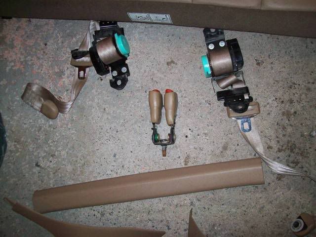

Installing belts
Now, the side panels i left on, i had someone carefully hold them (bending open while rear compartment door was open) open while i installed the belts.
there will be an insert hole for the belt retractors
On the top of the retractors there are two hooks that you would hook into the two holes above the insert hole. then screw in the retractors with a T-45 torx (one for each side)
you will then screw the belt guide in (2 phillips screws ea. side)
feed the belt through the access hole in the interior panel and then screw and pop the panel back in, then screw the belt hanger to the wall panel using the 5/8 socket.
Then screw in the bottom of the belts to the provided bolts near the floor (the nut is part of the belt itself and is a 5/8).
Screw in the dual belt locks using the T-45 torx (it will have a tab to insert on the floor)
