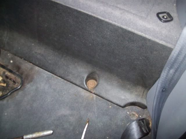

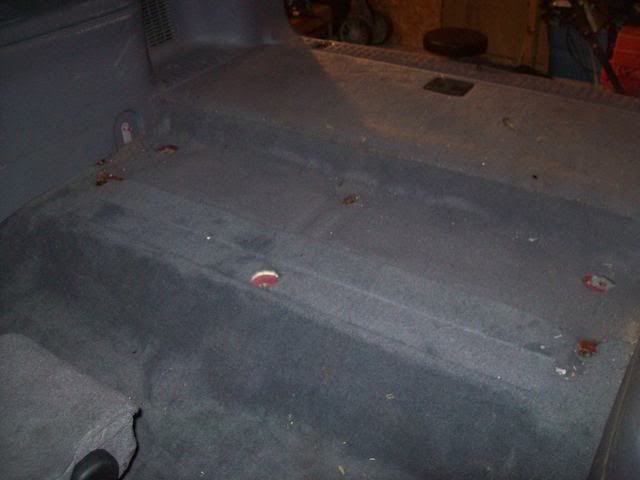

Now the storage

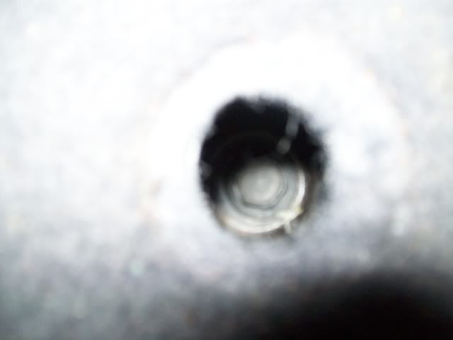

You will take the flat screw driver and pop these 2 caps (one on each side) from the floor and there are 2 bolts (7/8 socket) to take out with an extension

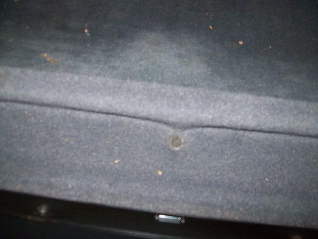

Open the compartment and there is one bolt (10mm) to remove
then in font of the compartment on the outside behind the middle seats are two more 10mm bolts that need to be removed.
Now the panels and storage is removed

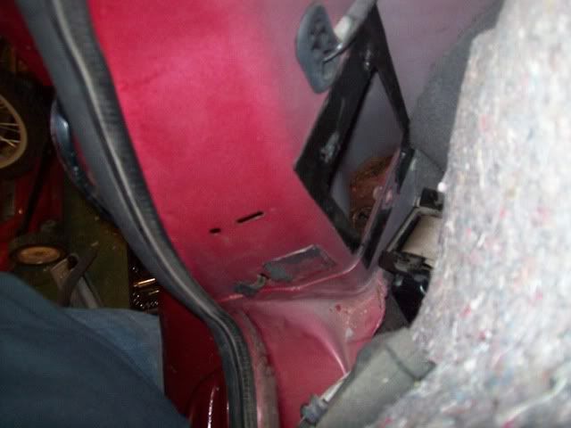

8

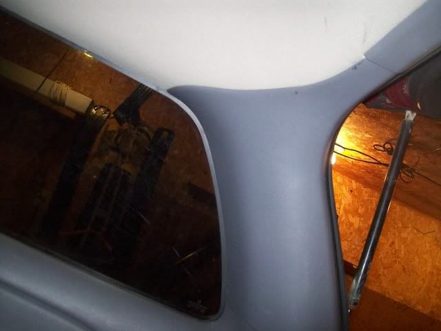

Installing belts
Now, the side panels i left on, i had someone carefully hold them (bending open while rear compartment door was open) open while i installed the belts.
there will be an insert hole for the belt retractors
On the top of the retractors there are two hooks that you would hook into the two holes above the insert hole. then screw in the retractors with a T-45 torx (one for each side)
you will then screw the belt guide in (2 phillips screws ea. side)
feed the belt through the access hole in the interior panel and then screw and pop the panel back in, then screw the belt hanger to the wall panel using the 5/8 socket.
Then screw in the bottom of the belts to the provided bolts near the floor (the nut is part of the belt itself and is a 5/8).
Screw in the dual belt locks using the T-45 torx (it will have a tab to insert on the floor)

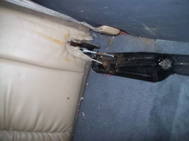

5
Installing Seat
Bolt the seat in using the 7/8 socket (4 bolts, 2 on ea. side)
Pop and screw the panels back in (usie the plyers to pull out the metal inserts because most of them will come off the panels and stay in the metal insert holes)
Now, Third Row seats are installed
