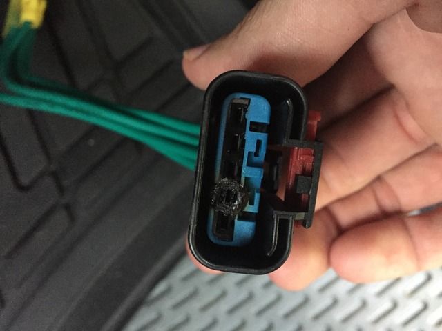

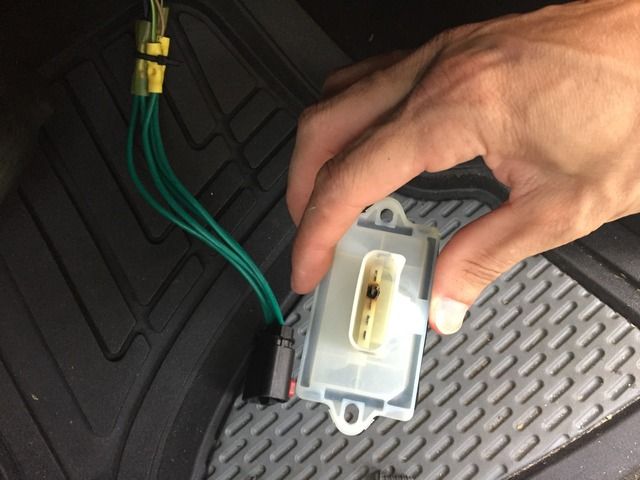

So I've had my Dakota for 1.5 years. I have replaced the resistor 3 times. The 3rd time, I replaced the plug and wires due to them burning up as well as the bower motor. That worked from Sep '16 until now (jul '17). Just today the blower stopped and started back again. Now, pin #2 burned up again on the resistor and on the plug. I'm not sure what else to replace since it's all been gone through. Any ideas on what my issue is? I went to Advanced Auto and spent another $12 on a BWD resistor instead of the cheaper Doorman brand. Maybe it'll last longer...maybe not.
What else could be causing my resistors/plug to burn up?

Update: just driving it on lunch today burnt up my brand new resistor. The wires on the plug were too hot to even touch. With a new motor, new plug and new resistor...what could be the issue with it getting to much power?
