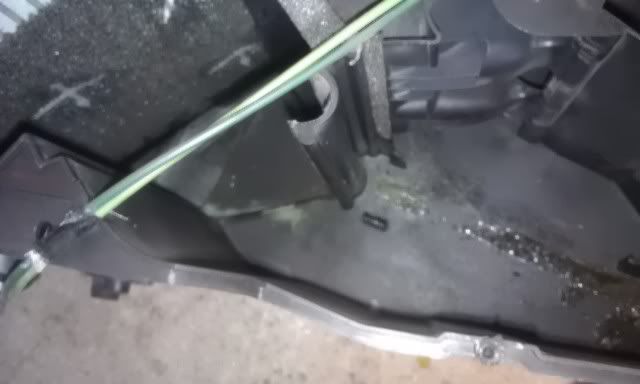

So I had toxic vapor that wreaked of exhaust and coolant coming from my vents. No fluid on the floor.............then one day I had the fluid. My core had a leak. Here is how I replaced it without COMPLETELY removing the whole dash.

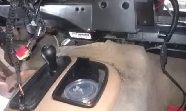

Next go ahead and take out your dash cluster and slowly guide your disconnected shifter cable. Do break it, it is a dealer only part.
You should have something that looks like this:

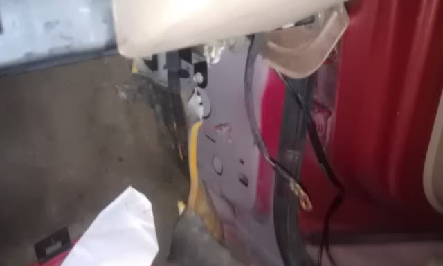

Okay, look back at this pic closely. There is a ground wire on the passenger side just below that 13mm bolt. Remove that ground wire. If you have the Infinity sound system unplug the wires. I have it, but am not running the wires.

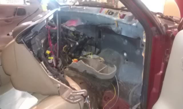

Okay here is where you really need a second person. With one person on either side lift up and out on the dash. You need to clear the bracket in front of your 4wd shifter. Once you get about 12" out you will need to unplug the blower motor wire connector (pic below) and a huge asz plug that goes into your firewall (no pic, too busy trying to get it out, PITA):
Keep pulling the passenger side out and walk the driver out as far as it will allow. After 45 min here is where it stands. PLENTY of room to get a heater box out.

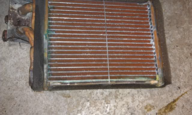

Box has a lot of screws. More on top and about 4 on the bottom side. You do not need to take apart the rod assy with the nut on the top. However you need to take that retaining ring off next to it. Also there is a black vacuum line on the driver side bottom held on my a screw. Take that off to get the top off properly.
Bad core! Bad! Go to hell!

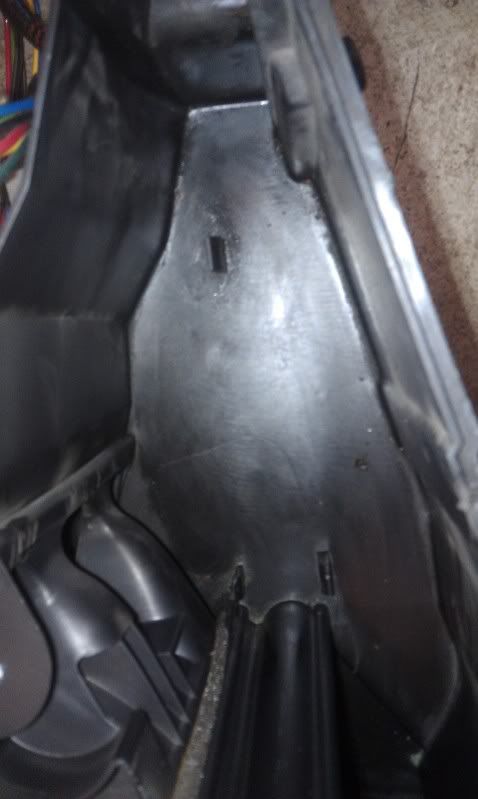

Clean this crap out:
So clean:
