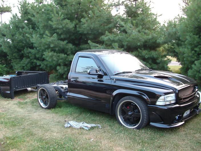

Here are some pics of my "backyard c-notch". Sorry about the Quality. Anyway, I bought a bolt on c-notch and bolted and welded it on. The bolts were more than enough to hold it, but the welds were just for piece of mind.
