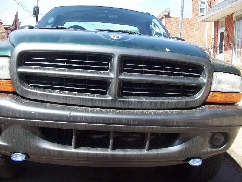

Yes, that’s a very good, cheap mod I recommend. You can use a piece of gutter guard from Lowe’s or Home Depot. I went all out and did just a grille shell filled with aluminum mesh, and I’ll make a stencil and paint a Ram badge on my AC condenser behind it in the same green my truck is painted. But now I have the same problem as you, gotta get it running first 😂
Here’s the only pic I have handy of my grille, from when the zip ties were still in while the glue was drying. I still need to refinish it since my first paint job got rained on. And also a link to a write up I saw suggested in this thread.
Cool idea. I always like thinking outside the box. I never thought of using gutter mesh at Lowes. That said, my dad always told me, when he was working on a project, that he'd ask different people for their opinions or ideas. He'd say that it didn't mean he was going to use anyone's suggestions; that he may like their whole suggestion, or none of it, or he may like part of it. But he then had multiple views, ideas, opinions, or whatnot instead of just one, his own. That's a bit long winded but I hope you get my point. So I like asking people what they think or what they'd do.
By the way, here's the link for the grille model using safety door steel screen or mesh. It used to be sold by Lowes. It came in 4 x 8 sheets for roughly $15 next to the paneling sheets. But apparently they stopped selling it.
