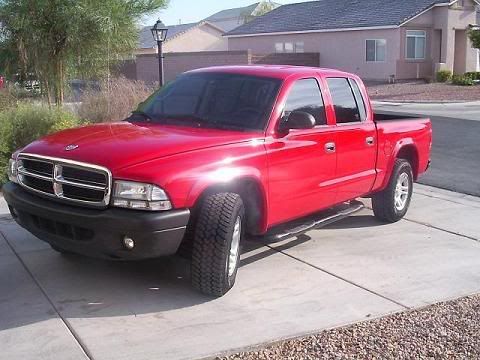

For all who dont know, I cut everything out front under duranged for its new buildup. The new buildup consists of 2 front 2.5 ton rockwells front and rear. I'm running 56" chevy lift springs in the rear and 52"ers in the front. Its getting full orbital hydraulic front and joystick rear controlled steering. It will end up with 53" michelin tires and 20x10.5 rims. The final date to be driving it seems to be set near the end of july give or take.
