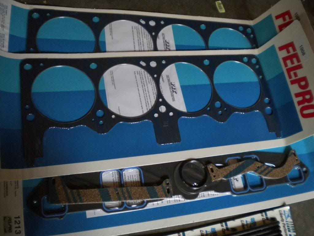

1999 Black dakota R/T club cab
Wanting to stay all motor.
Head/Intake gaskets
Head Studs/Timing Set/Pushrods
Mild cam by P.I.E
MOPAR Intake
Iron Heads worked over by P.I.E
