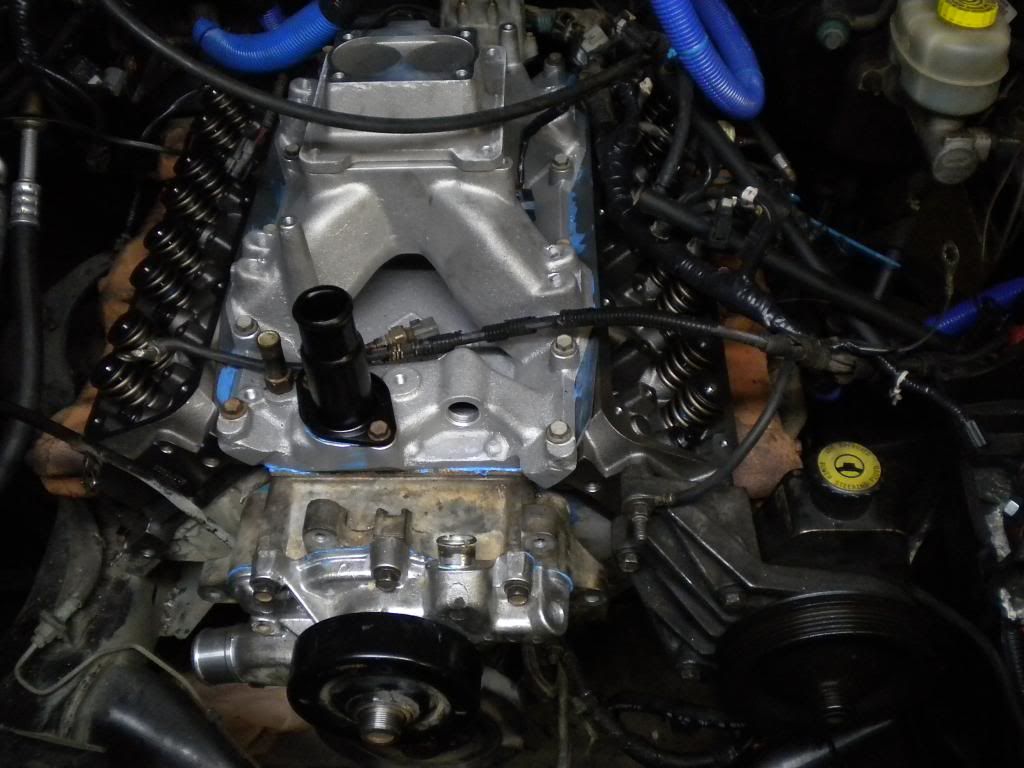

1999 Black dakota R/T club cab
Wanting to stay all motor.
Head/Intake gaskets
Head Studs/Timing Set/Pushrods
Mild cam by P.I.E
MOPAR Intake
Iron Heads worked over by P.I.E

Must be running lots of compression or are you just wanting a mild build? That 4bbl m1 is going to kill your bottom end on a mild engine.
good call, i have the 2bbl adapter in my garage as well.
just waiting on 1.6 rocker arms, sct tuner and 24lb injectors.

This is the kit I bought from Chris,
"Magnum Mauler Pak"
Bolt 250 bhp onto your stock block!
Kit Includes:
Super Tune Iron Cylinder Head Kit- Complete with Port work and all hardware
Rocker arms
Pushrods
Head bolts
Head Gaskets
Camshaft
4bbl M1 Intake
24lb. injectors
SCT Hand held Tuner
With a sound & stock bottom end, this kit will produce 425- 450bhp and maintain excellent drivability.
Unless they are putting a HUGE cam in that setup i doubt you will see over 350hp..... Not trying to say it cant be done, it can..... But most kit things like that grossly over estimate what you will make to get you to buy it....

First sentence of the thread says gen 3 club cab r/tard lol. I'm running a similar mods but with headers, gears, and a small stall. I think his goals are realistic in perfect conditions however he'll probably have a lot better luck with a bigger stall, especially with the 4bbl.
ive got the 2bbl adapter kit. Just not pictured.
I have looked around in the timeslip area's, my setup should net 13's with good reaction time, very high 13's
Even with the 2bbl adaptor and a 52mm throttle body it'll kill your bottom end. You'll see when you put it on.
what did you do to compensate?
I run a 2bbl m1 with a higher stall converter and a flat spot on the bottom end is still noticeable especially when it's hot out. I wish I had a 2800 stall to get over that hump though.
ok thanks, i will check out the prices.
What about advancing timing?
I'm assuming that Chris is going to custom tune it for you with the sct right?
