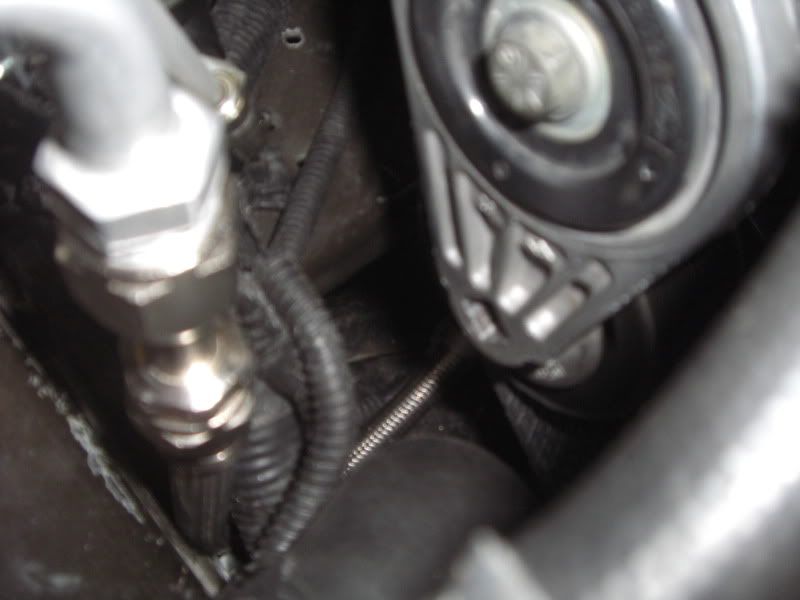

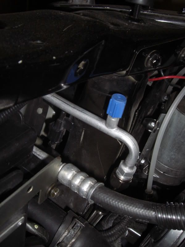

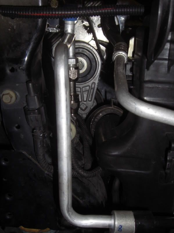

Well I hated how the line was just bent to shit and routed around the supercharger, additionally I cut the shit out of it with the pulley extending and hitting it.
So I had Doc's Blocks make up this line. They welded up the sensor port and the charge port. Only cost about 90 bucks shipped. Part of it is hard line and the rest is Stainless steel line to a 30 degree bend connection.
6.9 6 speed
5,421 Posts
very nice!!! That is one thing I always hated along with the lower rad hose.
