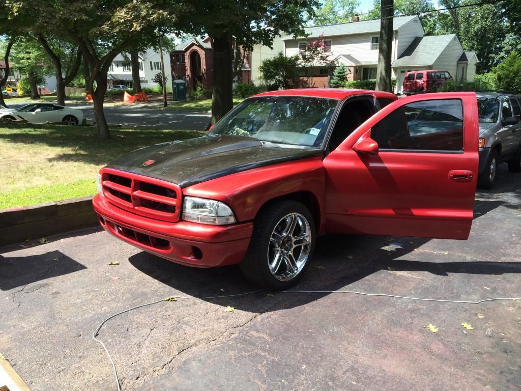

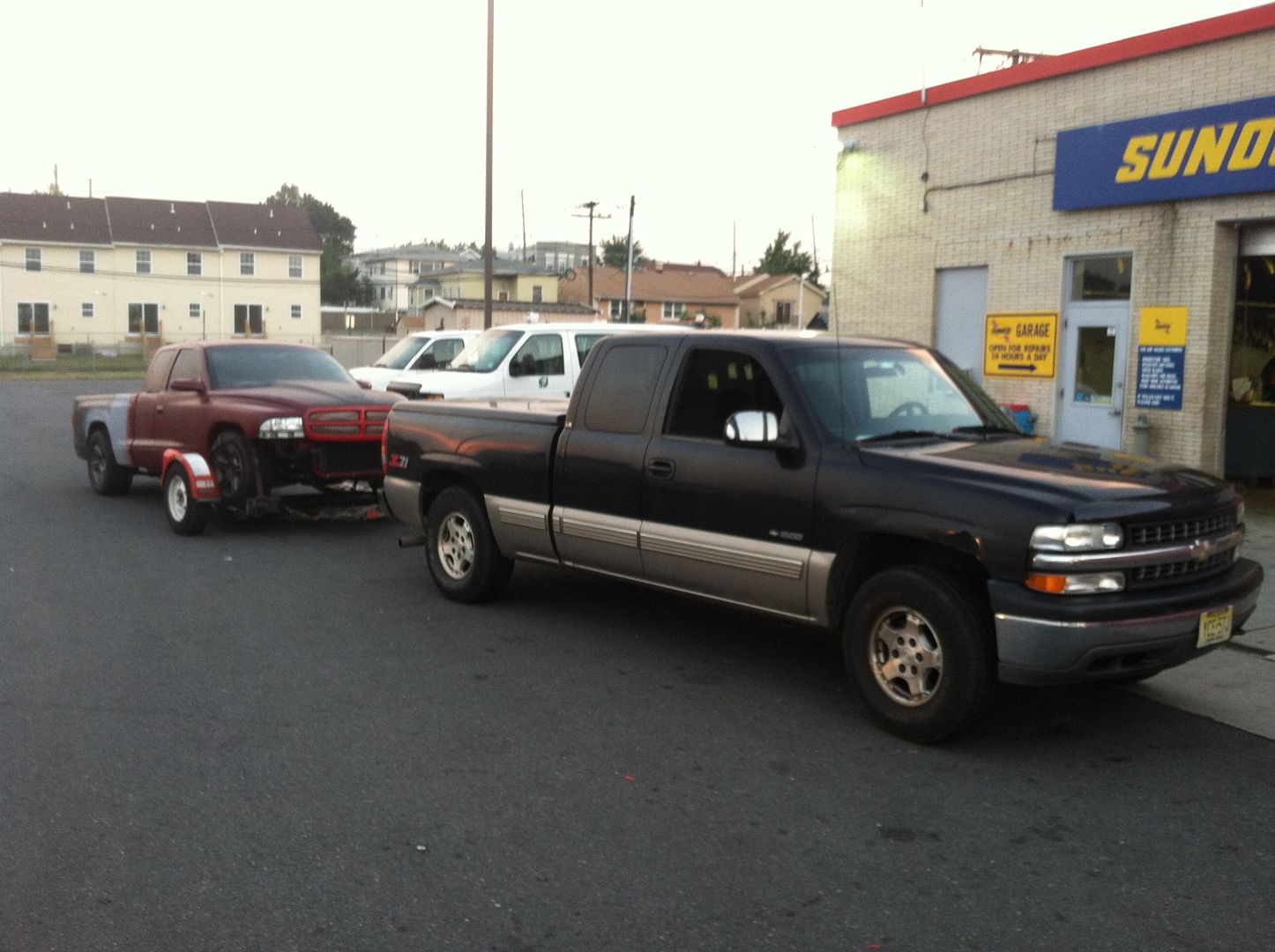

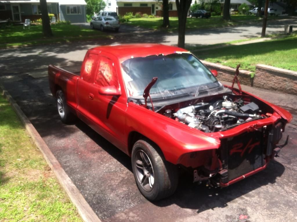

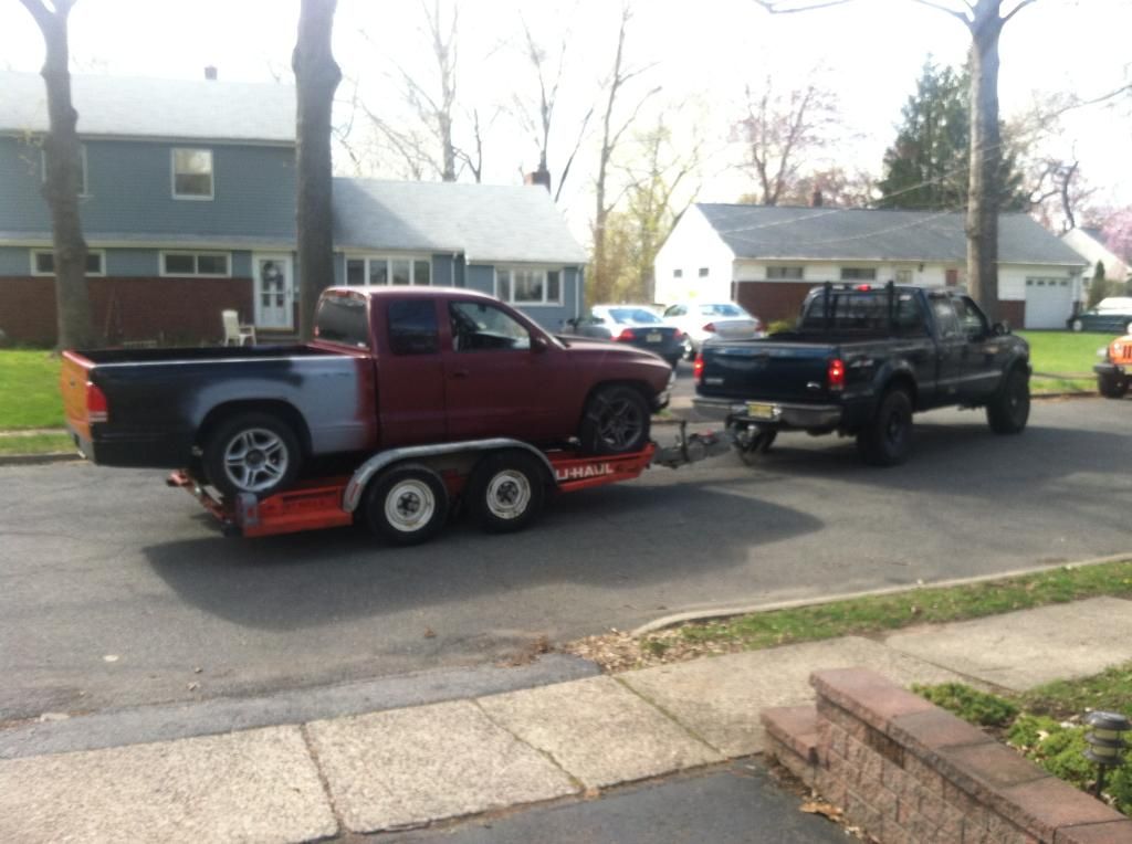

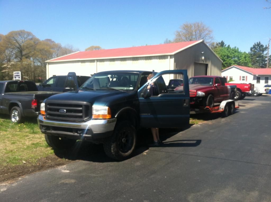

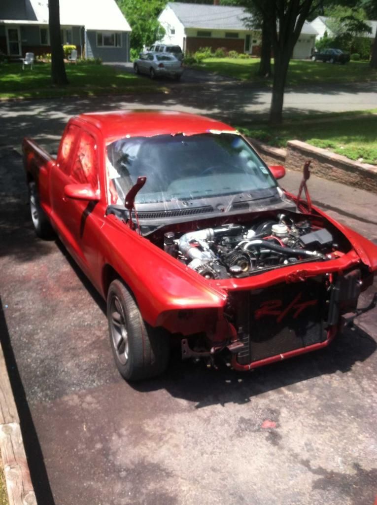

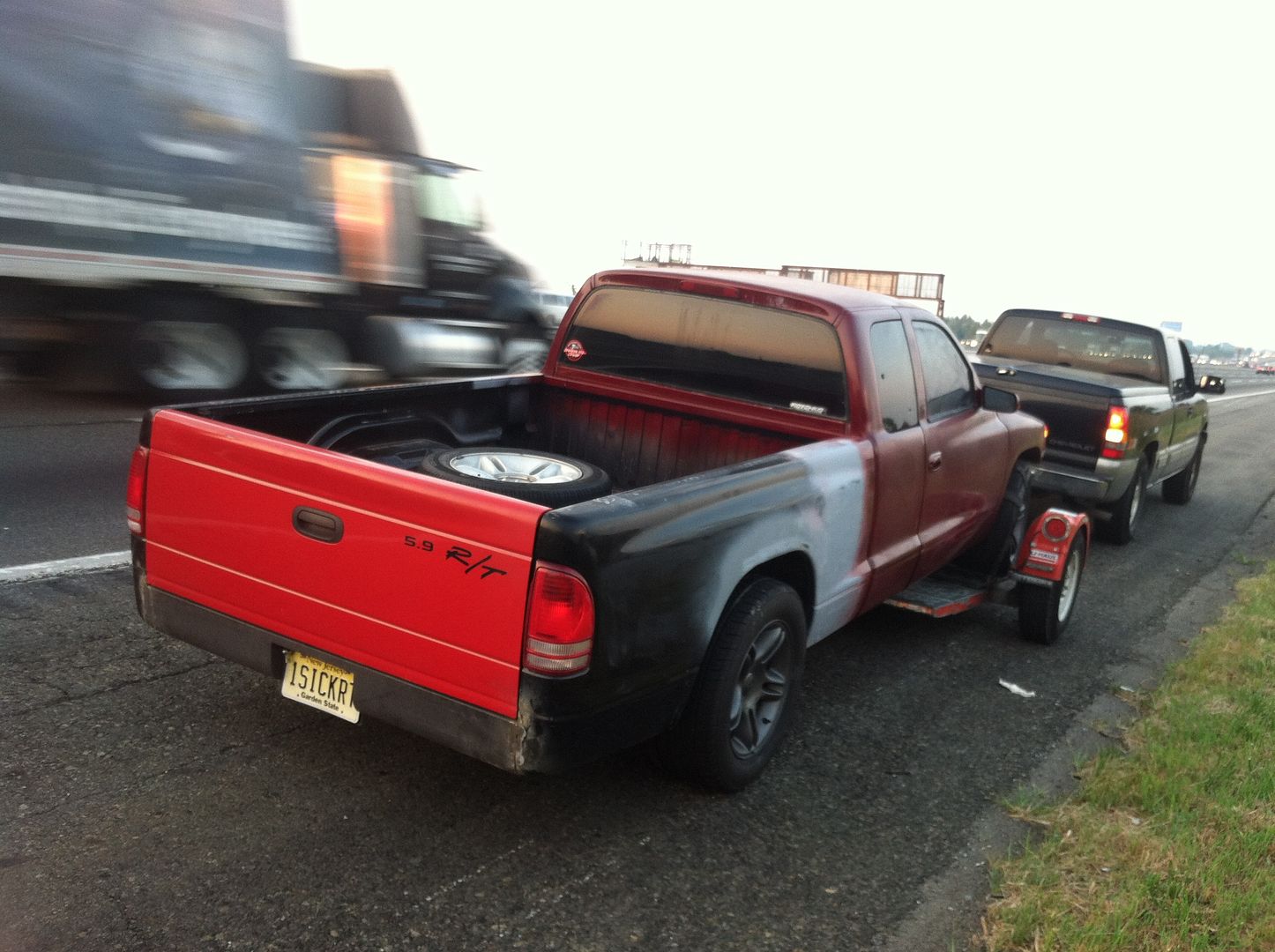

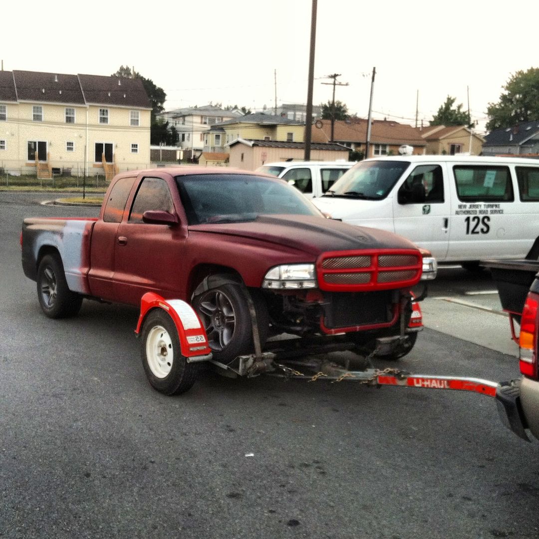

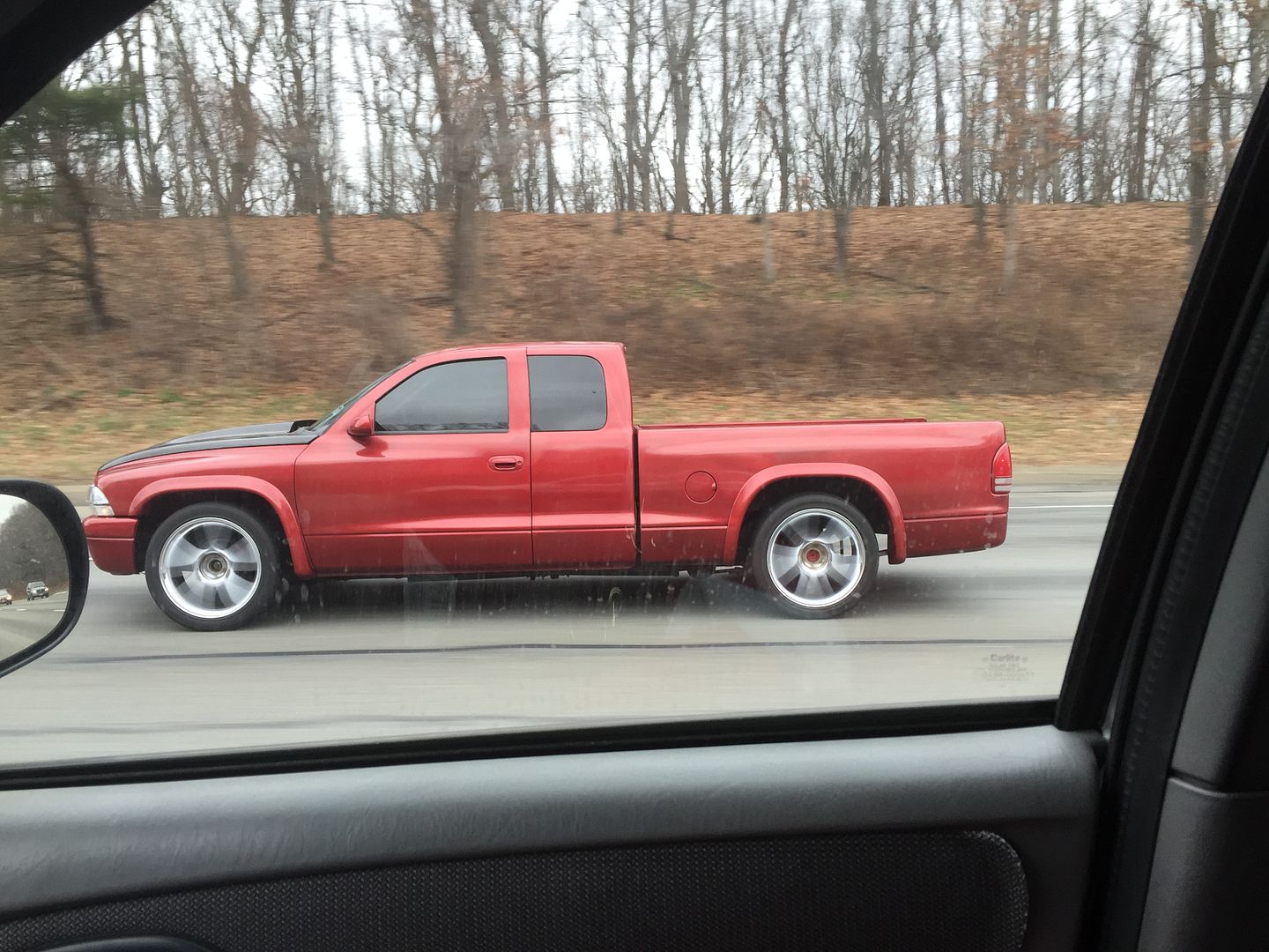

I couldnt get the truck to run right as it was popping through the exhaust and having a surging idle. I figured it could be the fuel sync or something simple, but without a scanner I had no way to check it. I was planning on bringing the truck down to PIE in DE to have him dyno tune it, so I put it on a dolly and brought it down there to him so he could diagnose the problem and then dyno tune it. Here are some pics of it at my house, then going down to PIE...not pretty I know.
I drop it off at PIE and a couple weeks later he calls me stating that there is no driveshaft in the truck. I took it down there with one, so it must of fell out on the way down there somehow. Both straps were on there, so I believe I got the wrong caps on the ujoints or the wrong ujoint and it just came apart. On the way down there a trucker came up next to us and honked, pointing behind us, I looked at the dakota and saw nothing wrong (just stopped to check everything a few miles before), so I was like WTF is this guy talking about? Long story short, it took about 2 months to even get a drive shaft put together due to getting wrong parts and trying to get my stock one lengthened.

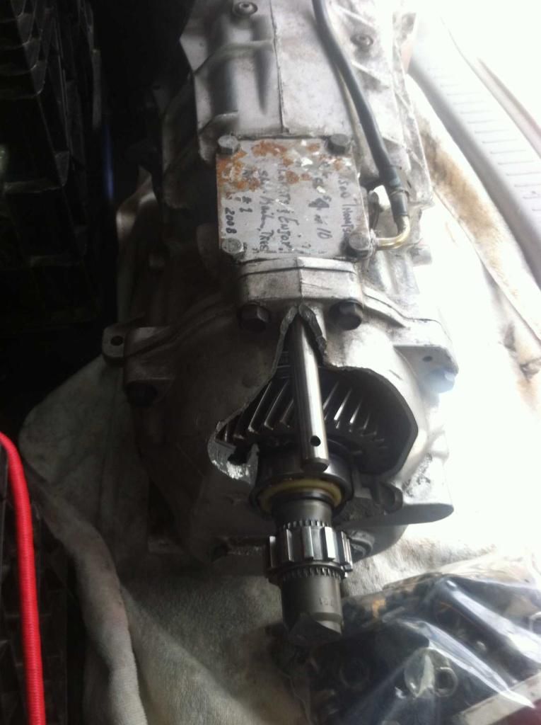

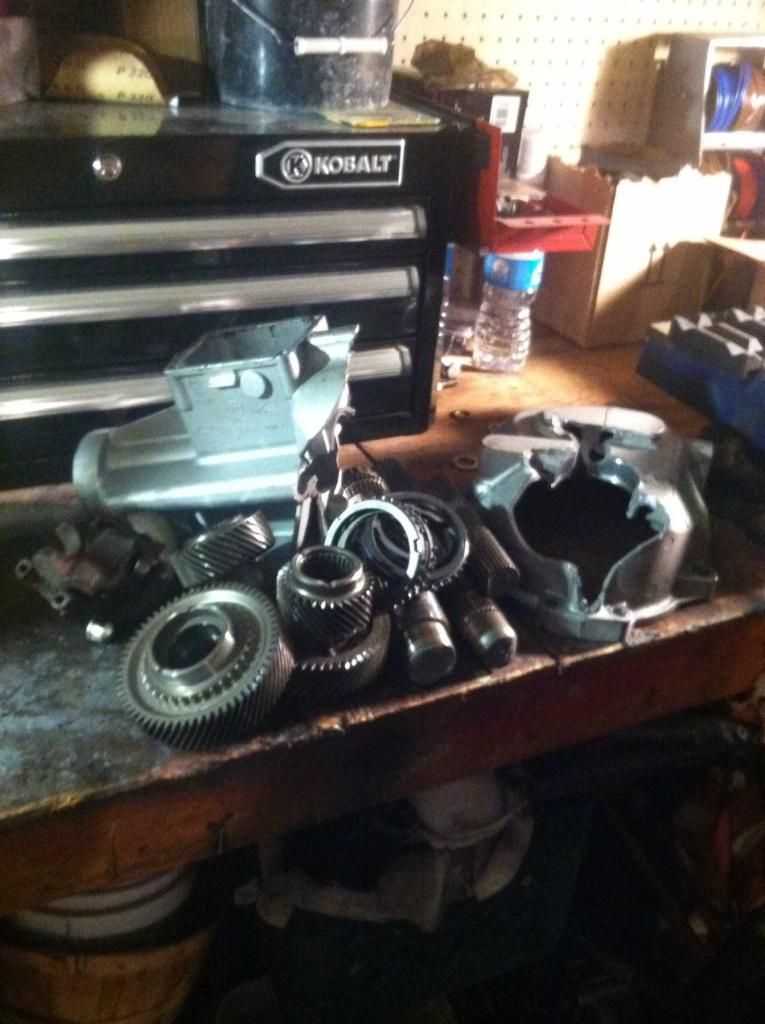

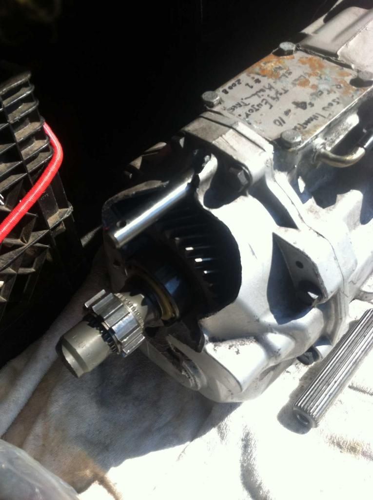

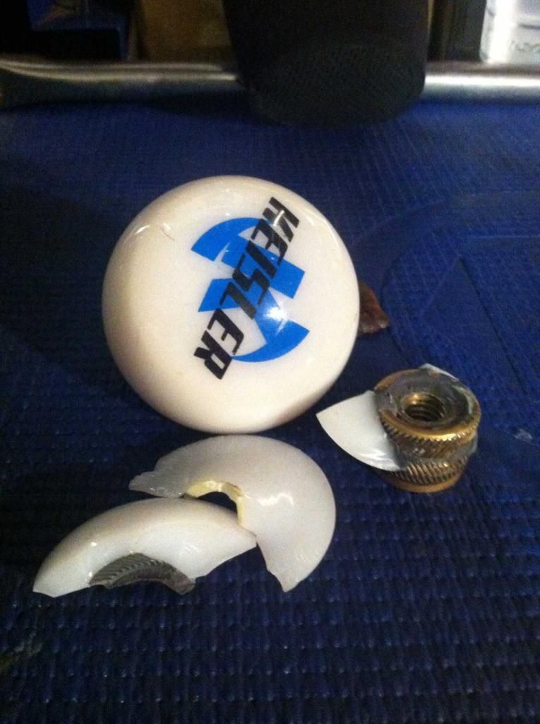

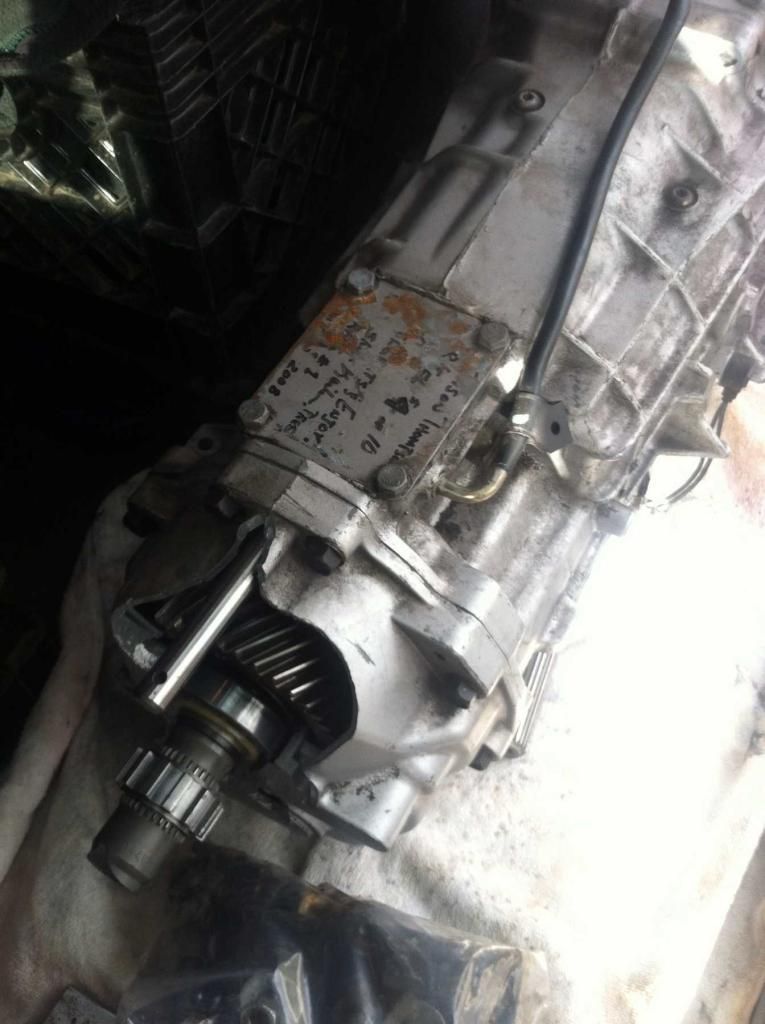

Now PIE can finally get to tuning this beast that it is running right. A little while later Chris calls me up and says the truck is pretty much done, just making a few more pulls. The truck made 535hp and 535 trq on 10lbs, but my bov was leaking so he was going to try and seal it up to make another pull on more boost. Plans were all set to go pick up the truck that saturday. Then Chris gives me another call and says he has some bad news....terrible new actually. On the final pull the truck made 598hp, but that came at a cost. The yolk on the rear end split apart, sent the drive shaft flying out of the truck to only get caught in my tire, and then snap the output shaft in the transmission and shatter the tail housing. Drive shaft totally bent up like pretzel (2 drive shafts gone) as well. The impact was so serve, that it cracked the shifter ball right in half! I had no idea what to think as I was getting ready to pick it up and now catastrophic failure happens.

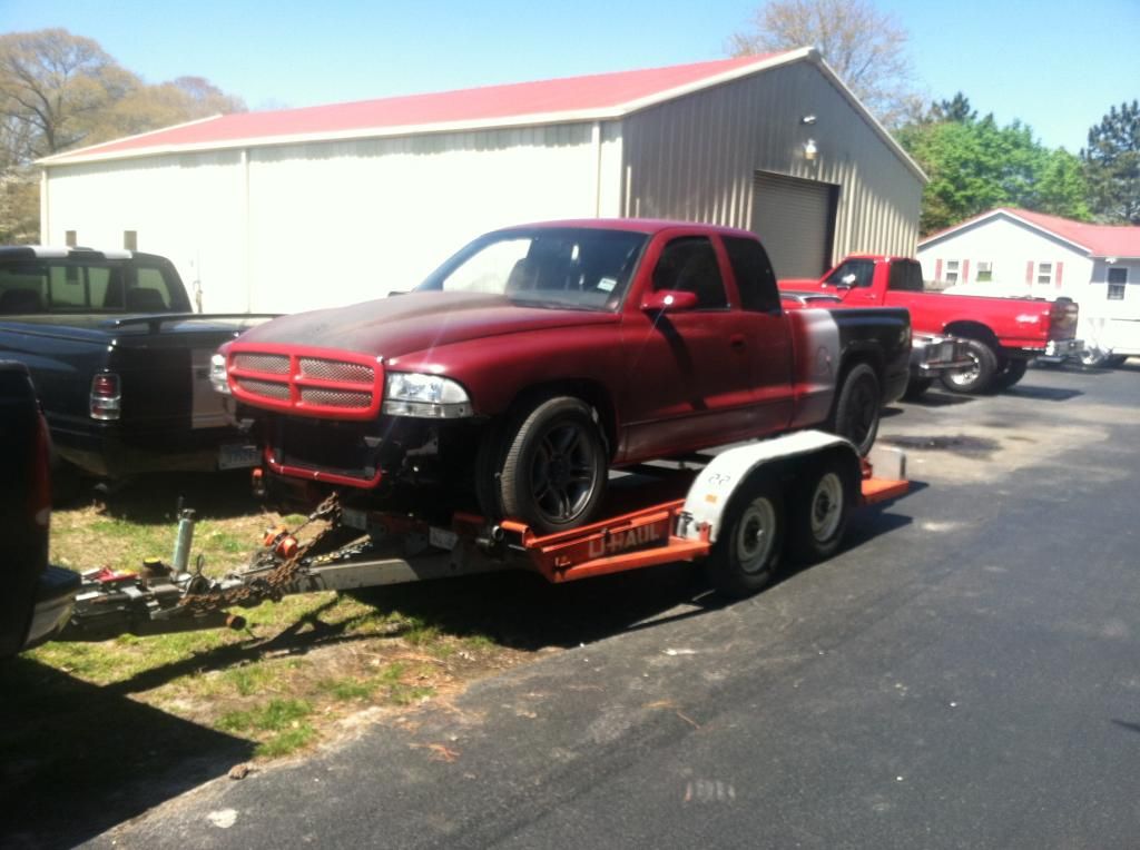

PIE was going to ship the transmission up to hanlon motorsports in PA to have them rebuild the transmission and he would reinstall it; he didnt want my truck to leave his shop in pieces. However, instead of letting the truck sit down there for even longer and paying for shipping back and forth on the transmission, I decide I would just pick the truck up how it is. Besides, there is a lot of other stuff I could be doing on it. Chris removed the transmission for free and I picked up the truck the following weekend.
Here are some pictures of the truck on its way home from PIE and the transmission carnage.

Now that the truck is back at my house I can start making head way on the truck. That tuesday, I drop off the transmission to a place 20 minutes away from my house, Rockland Standard Gear. The do a lot of work for professional road racing teams and they are very well known and reputable, so I figured I would give them a shot. I bring in the trans and a bunch of guys there have never seen a trans come apart like that. When I told them it was a keisler unit, they all rolled their eyes and said they are out of business for a reason. A few days later they give me a call and say the trans is completely shot and will need a full rebuild. They could save some of the gears and syncros, but since they are tearing it all apart they recommended I just replace everything. They also said I should upgrade my output shaft as it is a stock camaro t56 output shaft, NOT the viper shaft keisler advertised. It doesnt have a manual dog box either and a lot of the other advertised stuff keisler listed, but it does have a viper input shaft. They tried to up sell me on a bunch of stuff, but I figured if it last behind a bunch of racing and launches from Jason T...it will be fine behind my street truck. All in all it only took them a week to rebuild it and it cost me $1,800. Now that I have my transmission back , I went a head and reinstalled it in my driveway. Everything went pretty smooth and I installed a new yoke and my third freakin drive shaft!

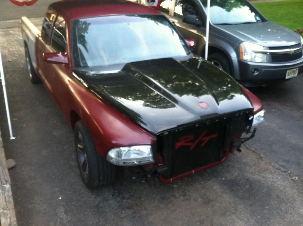

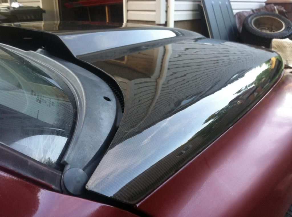

Between all that I also managed to trade my cowl hood for a real carbon fiber hood...one of five I believe. I got it from Kris down in south jersey, he is on here and goes by krisr/t...you guys know who im talking about. Cool guy with an even cooler truck!

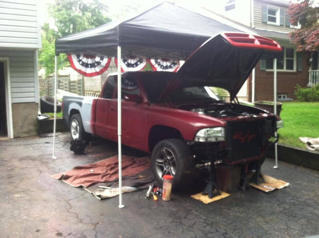

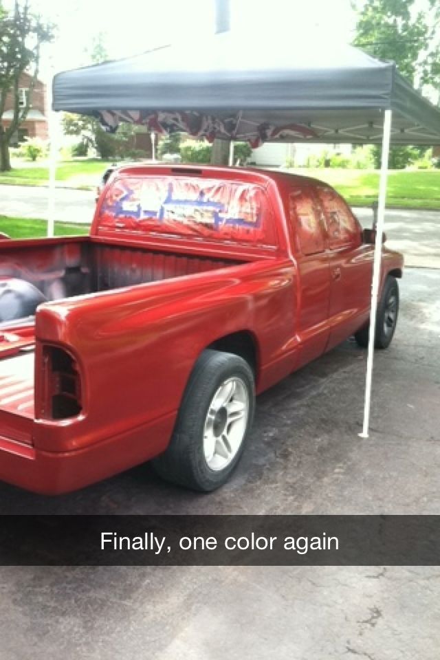

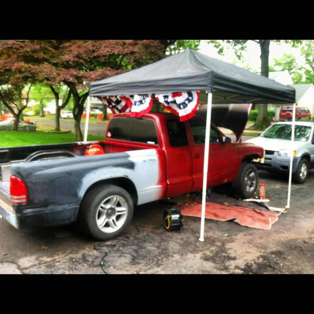

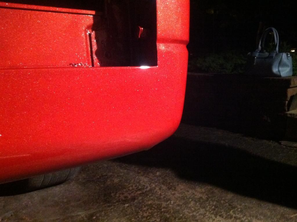

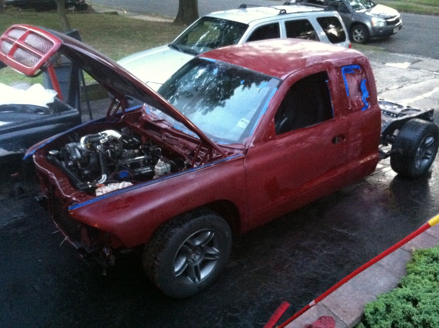

While all this was going on, I was doing more body work on my truck and putting the whole thing back together. Putting in the seats, interior, wiring some stuff up, cleaning it up, etc. The new color for my truck is called fire thorn pearl red, which I ordered from TCP global. When I got the paint for the first time, it was A LOT darker then the paint chip online...a lot. Since you cant return paint, being a hazmat item, I was stuck with it so I went ahead and painted my engine bay, cab, mirrors, and mirrors. However, I needed more paint, so I go ahead and reorder the SAME color from the same website. When I get it this time, it is the original color that I wanted. So I went ahead and painted over the old color and did the whole truck, but now I am stuck with a different color engine bay. I did waste a lot of paint the first time, but it is my first time ever painting a vehicle..live and you learn I guess. Here are some pictures of the painting process

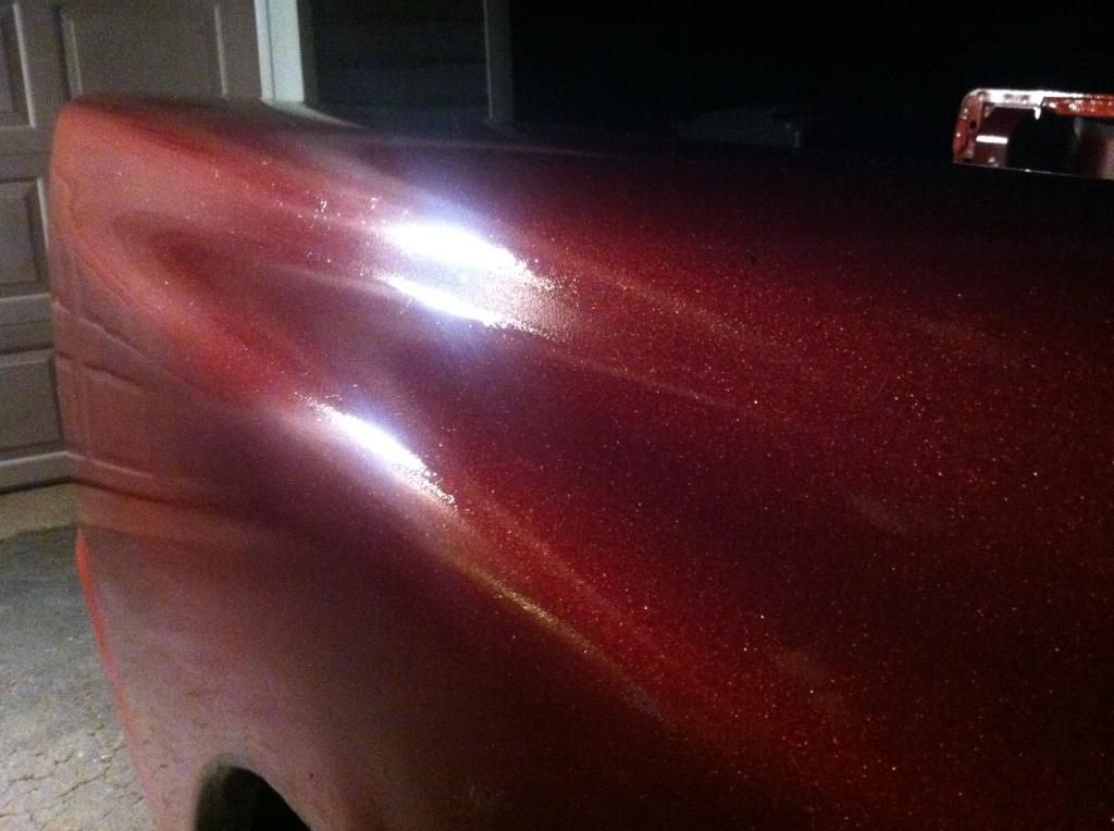

After painting the truck began to cut and buff it. I go the driver side all done, but never made it to the passenger side lol. I'll get to it in the spring. Between all of this there was a lot of other stuff on the truck I was doing, going back and forth with tunes, fixing oil leak, working on tailgate, etc.
