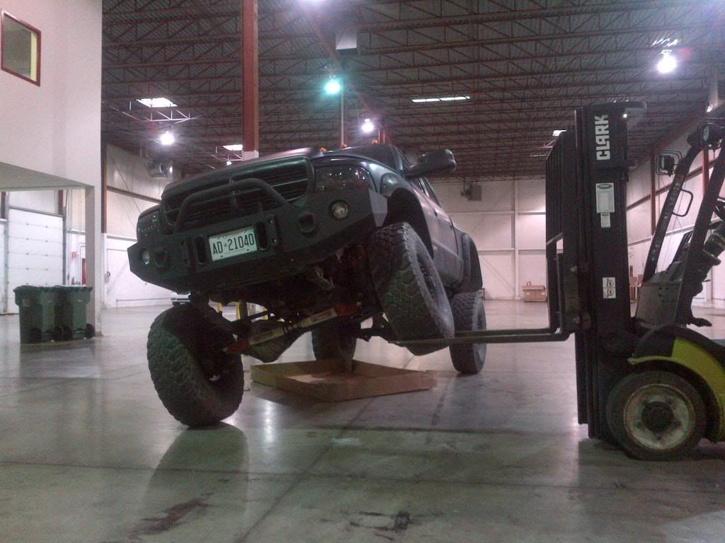

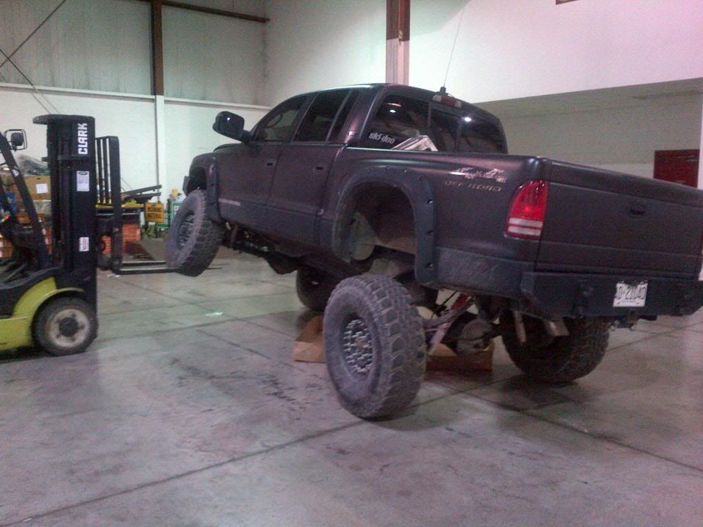

Props dude. Seriously, props. Very well done. Love the fender. Always wonder why the fawk bushwhacker never made a set for our trucks???
I gotta say though, 5.9 cummins is pretty overkill in our "smaller" trucks, you are still limited by your chassis on the towing. Not that you'll use this to pull a 40 ft trailer, but still.
Great job man. Great job. <handshake>
