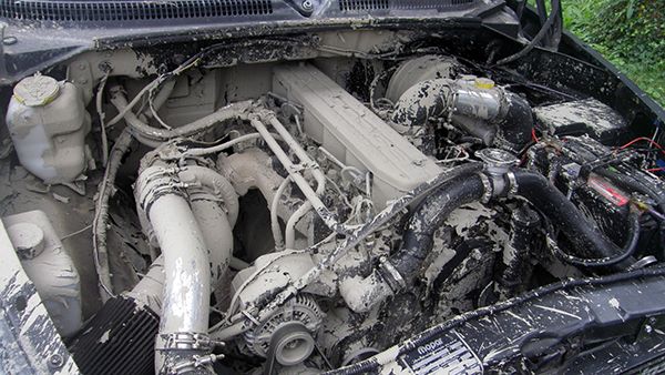

The motor got turned up a bit aswell, I put in a 3200RPM Governer spring, a Denny T fuel pin and built an adjustable wastegate for the turbo. The truck has alot more poser now and its just about maxed out without going to larger injectors.

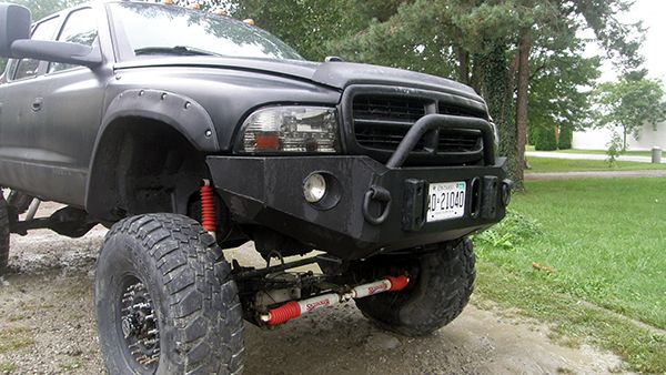

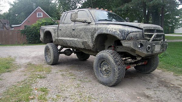

Went mudding over the weekend. The truck is way more capable than I ever could have thought. There really isnt much it cant do.

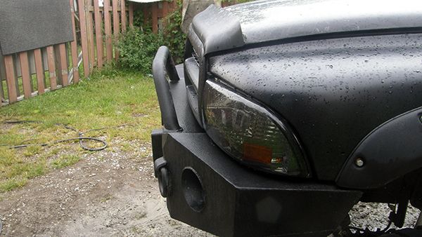

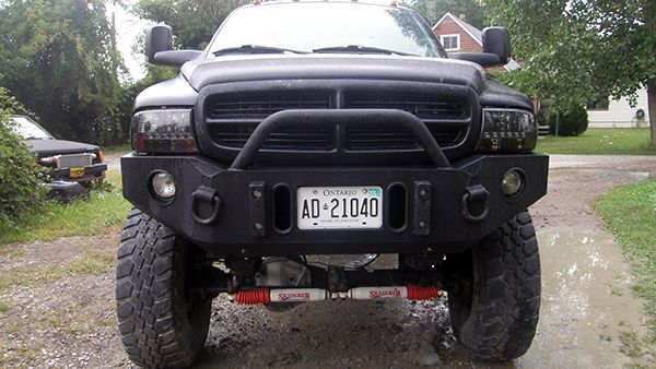

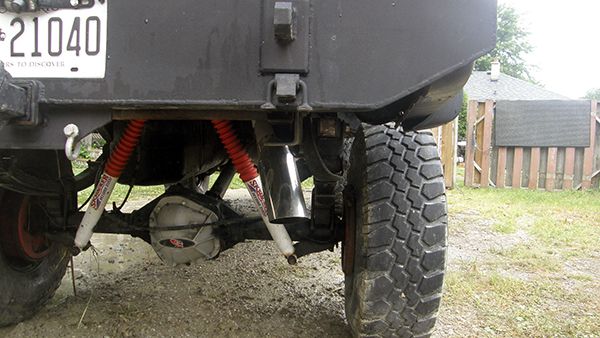

Also I frankensteined from flippy tow mirrors on it so I can see where the hell I am going when I back up. Build myself a big steel front bumper since the stock one looked way out of place. The stack is gone and its soo much nicer to drive, its not screaming in my ear anymore :)
Next on the list is 42" or 44" tires and some 4.10 axles.

12,949 Posts
That bumper is really nice man, and the stack glad its gone, sooooo much cleaner now. Did those mirrors come off a ram?

12,949 Posts
damn thats nice man, The mirrors fit the personality of the truck, Im not big into stacks, I love it without it now.
