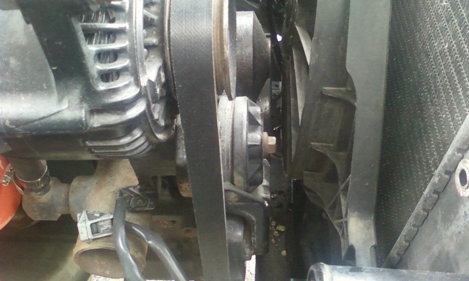

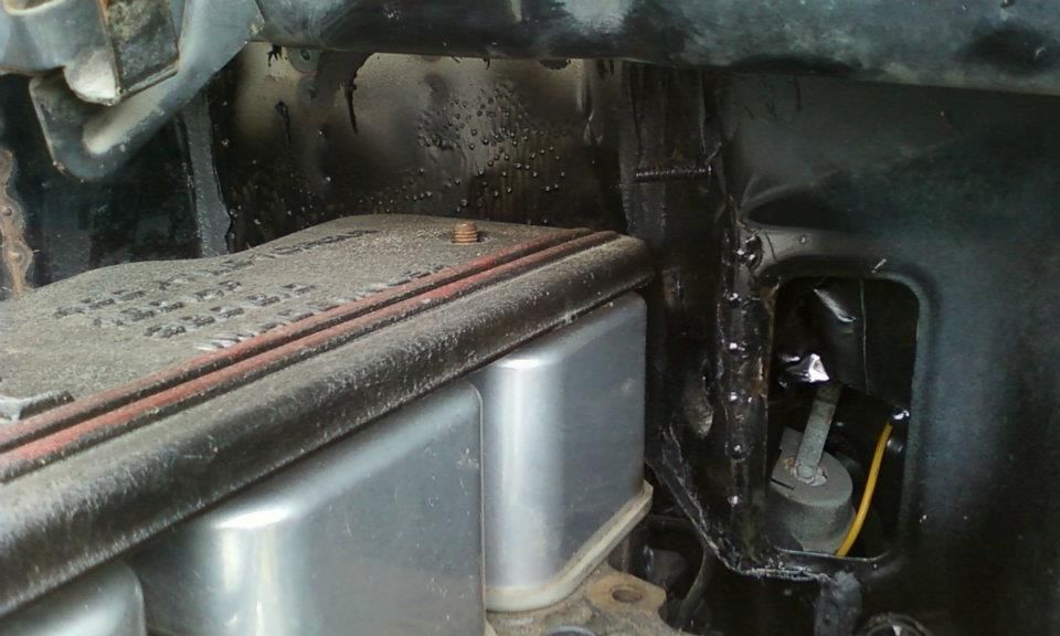

After making my body mounts and box mounts it was onto modifying the body to fit the large inline 6. To do that the firewall had to be cut and a center section pushed 4 inches back. In order for the heater box to be retained it to had to be modified as well in order to bolt to the firewall. I had to cut and re-seal a mirror section of the heater box to the fire wall and then re plumb the heater core from one side of the box to the other(where the AC originally came in) so that it would clear the motor.
Then it came time to make the steering shaft(half Dakota, half Ram), the throttle linkage(Cummins cable with a crimp ball so that it would be tight using a Dakota pedal, and wiring harness. I used a stock Dakota engine harness so bring power to the inside of the truck and then made my own fuse block and added all the necessary circuits for the truck(power windows, power locks, and so on) I also had to build my own turn signal circuit, wiper/washer circuit, horn circuit, and gauge cluster. The truck uses no PCM as the motor is fully mechanical.

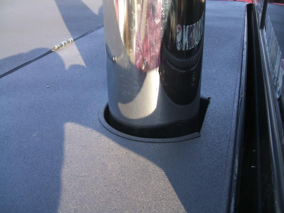

Next project is to finish the home made flush mount hard tonneau cover.

Finished the tonneau cover and put on my new headlights
