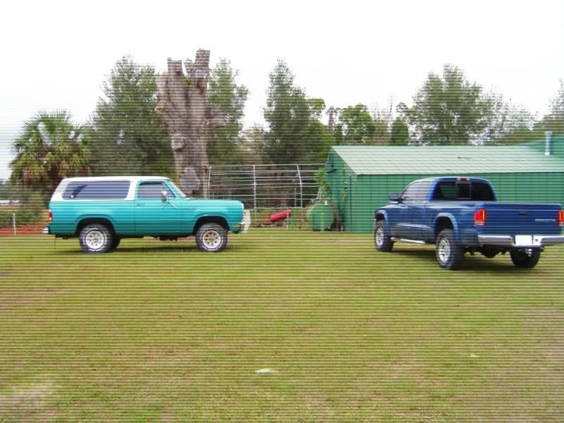

3 years ago I bought a 1978 pop top ramcharger for 600$ as a graduation present to myself for graduating highschool :mullet:.
The day I drove it home, sitting next to my dakota.

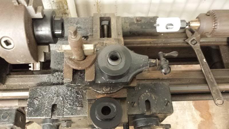

I ordered a new bodymount kit from energy suspension, and im not exactly sure what they sent me...
An RC has SIX bodymounts on the tub and a couple up front for the core support. They have ROUND holes for the mounts to center on...
Energy suspension sent me FOUR two piece bodymounts with ELIPTICAL centers?!?
I wasnt sure what to do... return them and wait untill the correct set arives and for more free time?
Hell no...
Stuck them on the lathe and turned thoes ovals into circles. ;D
They will work untill I get the correct kit.
Anybody have a "Superjustable" wrench? ;)
