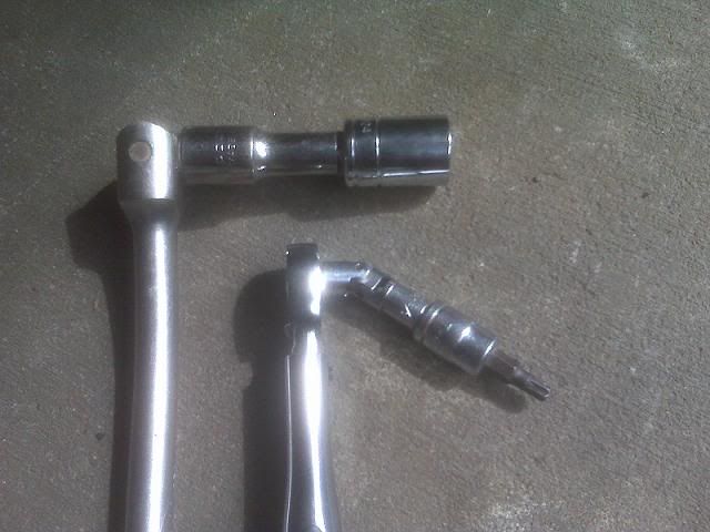

Here are the tools I used to loosen the lock nut and tighten the adjusting screw. No extentions would work with a wratchet as you have very little room to get in there. I finally found that a 1/2" breaker bar (my breaker bar is also bent and has a swivel head which made things easier) with a 2 inch extention and regular 3/4" socket (not a deep socket) fit perfectly in there and was long enough and had enough umph to break the lock nut as mine was very tight. For the adjusting screw I used my 1/4", inch lb. torque wrench with a swivel extension, and a 1/4" to 3/8" extension, to a 3/8" torx bit (the kind that are fixed to a socket), I believe T40 but I dont remember sorry. I was not able to hold the adjusting screw while tightening the lock nut as I used a socket to tighten the nut, so I just winged it and watched my mark I made with paint on the screw and it only moved about 1/8-maybe 1/4 turn or so while tightening the lock nut so I am not going to worry about it. Next time I will back it out an extra 1/4-1/2 turn and then by the time its tightened it should be just right.
