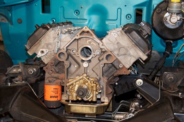

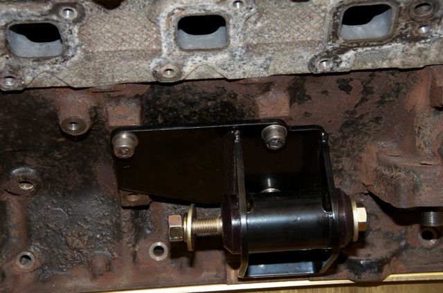

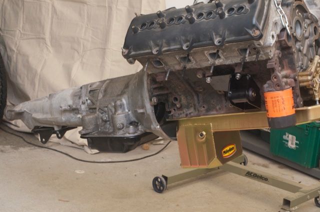

Hey, what's up guys I just stumbled onto something, Schumacher Creative Services is getting ready to release their motor mounts and oil pan specifically designed for the 97-2004 Dakota. I spoke with Michael earlier and he said he has all these parts in stock except the pickup tubes, they are on backorder. The cool thing is the parts will be less than $500.00. Michael also informed me that for 97-98 Dakotas, you will need to change the brake booster, booster bracket and pedal to a 99 and later Dakota for Hemi installation. I am starting to feel a lot better about the swap because of these parts. I will just need the wiring harness and Hotwire auto has them available as a plug-and-play set-up!

Well I have done a lot of research and after talking to Michael the Hemi will go in the same location as the drivetrain that is in the Dakota that you are swapping out. The harness is plug and play so no worries, basic hand tools, cherry picker and might possibly need to get the driveshaft custom made. You will have two companies that will give you tech support.

I noticed these are for the 2wd dakotas.. Do they make a bracket for the 4wd dakotas? Oil pan clearance should be the same, but the front diff bolts to the motor mounts on the 4wd dakota.
Well just ordered the 99-04 Dakota brake booster with spacer and brake pedal assembly so that the Hemi will fit in the engine compartment, like the one in the picture. I found out last week that 2003-2004 V8 Dakota's have 9.25" 12 bolt rear ends with factory disc brakes and they are fairly easy to locate for around $350!

I just would really like to use an LX engine in the Dakota, Bruce will the engine with it's bracket configuration even come close to working with these Motor mounts and oil pan?
The LX alternator and AC compressor are mounted lower which makes it 3-4 inches wider. I'm not sure if that becomes a problem or not. But I do know that the top water pump outlet is on opposite side (passenger side) as the Ram motor (drivers side). So you will need to replace your radiator with one that has top outlet on passenger side. Check out this diagram: http://www.hotrodlane.cc/PDFFILES/hemicarmeasurements.pdf

I got the 2001 brake booster installed today and it does give me a lot more engine clearance with the 3.9 still in the truck. The booster did take a while to installed due to having to elongate the hole in the firewall where it passes through it was clearanced about an inch closer to the drivers side of the truck, and I also had to cut off some material on a bracket that holds the proportioning valve as it was hitting the new booster, which required me to have to remove the left inner fender to access the brackets mounting bolts. I am still waiting on the 2001 Dakota brake assembly. The dash and headliner harness that I removed from a 1999 Dakota was a huge fail as the main plug at the firewall was a little different and pinned different, so I am still looking for a 1997 Dakota that I can remove all the wiring from so we can have power windows and locks, it was very disappointing yesterday as my son and I spent four hours removing the whole interior out of a club cab!
